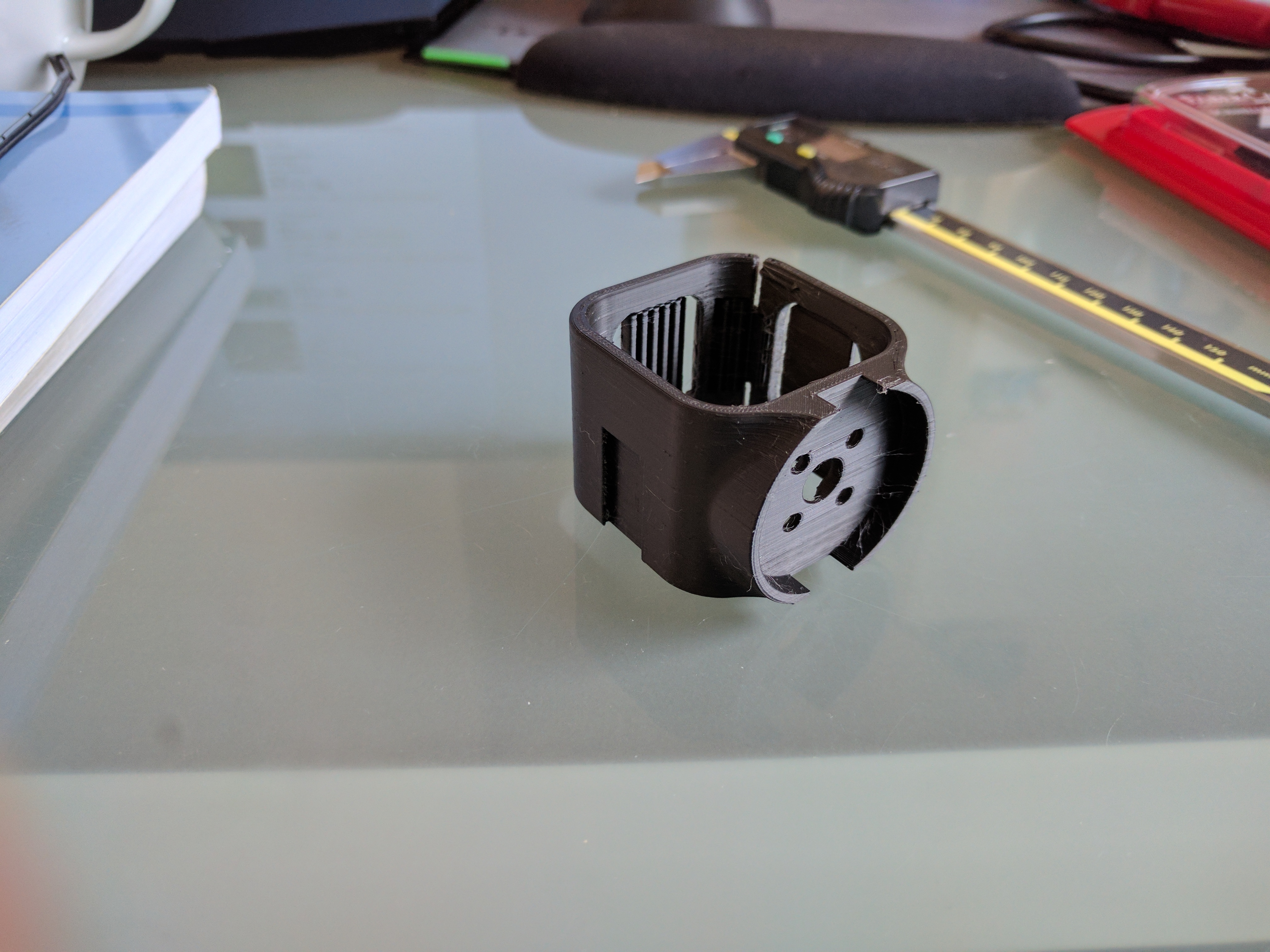

I’ve recently bought some airbrush nozzle adapters from him and I have to say I’m blown away by them. There are several advantages that come with them:
-small nozzle sizes available (I use 0.3mm)
-cheap nozzles (~5€ per 5 nozzles)
-perfect overhangs!!! The small pointy nozzle seems to keep the heat away from the print much better than standard E3D nozzles do.
-much more clearance at the nozzle tip for airflow and a much better view whilst printing small parts
-they seem to do not adhere to molten filament as well as brass nozzles do
So to conclude:
