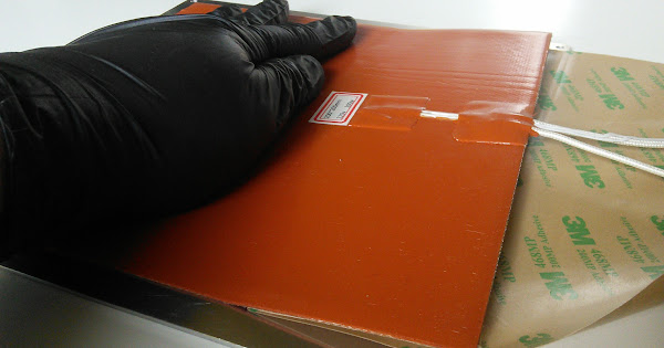

Well, I decided to fix this and here’s what I came up with after doing some research here (thanks!) and elsewhere - a low cost mains voltage heated bed for less than 30€ total (most parts ordered from china).
MK3 style aluminum plate ~7€
200W, 220V, 200x200mm silicone heater with built in thermistor ~7€
SSR ~5€
Fuse and fuse holder ~5€
Enclosure for the SSR, fuse holder ~1€
Optional:
203x203mm sheet of BuildTak ~10€
I haven’t installed it yet, but in a quick test run it went from 27°C to over 80°C in less than two minutes, so it should work just fine. Can’t wait to try it…

quick update:
I finally got 'round to installing and PID tuning the heat bed - what can I say? It works so much better than before. Heats up from 20°C to 70°C in less than 90 seconds. Failed first layers are a thing of the past. Best upgrade I made so far.
