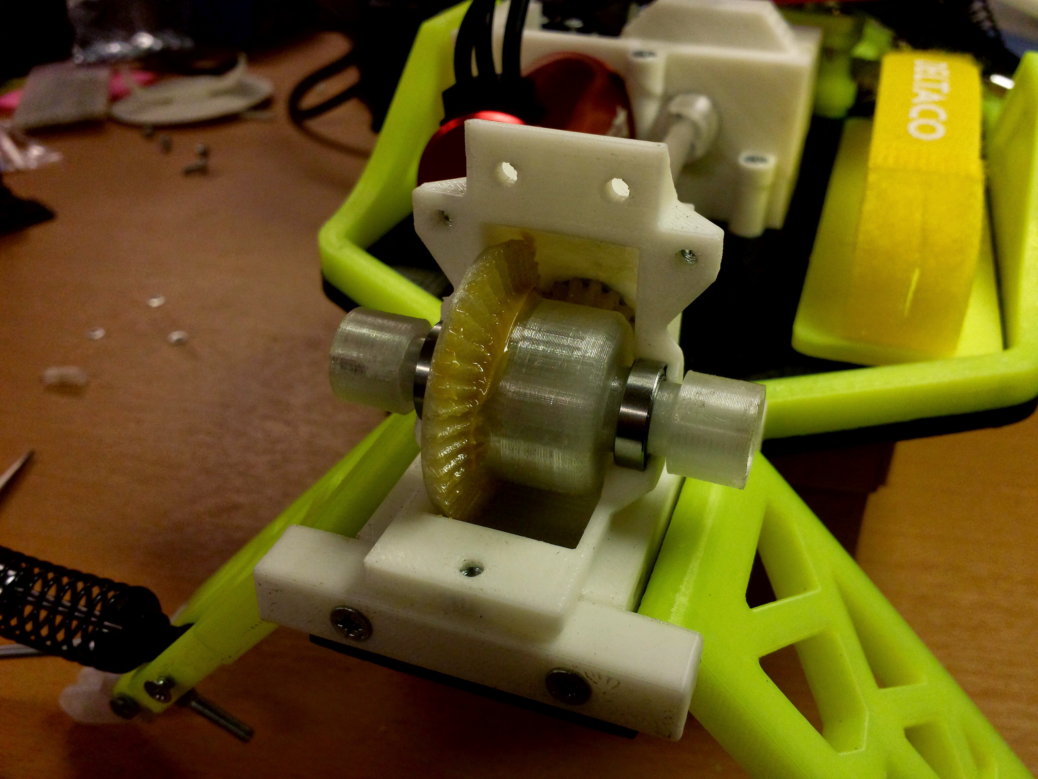

Today I finished my new parts in T-Glase which I had/have very good hope
Today I finished my new parts in T-Glase which I had/have very good hope in providing more durable parts for some of the parts on the truggy. PLA just isn’t enough for some of the pieces.
Well, a combination of a major underestimation of the motor (damn it’s fast), being the first time in my life driving anything else than a low end toy RC car, and that some of the parts still wasn’t durable enough it ended in a pretty bad crash.
Played around with it for about five minutes, just testing the steering and throttle. Then I took it to the lawn, hit full throttle, and my first attempt to turn in full speed (why the h*ll would anyone do that?) resulted loss of traction and 5+ flips.
I think I found all the pieces =)
back to the drawing table
I think anyone not used to decent brushless electric cars will always floor it without realising quite how quickly its going to pick up :stuck_out_tongue: it’s fine as long as no one’s shin was in the way!
Oh yes, for the next run I will seriously consider to recalibrate the throttle on the remote control so that max throttle on the control is just 50-70% of the motors max RPM. Printing is half of the point with this project, but would be nice to take the car for a spin longer than 5-10 minutes =)
