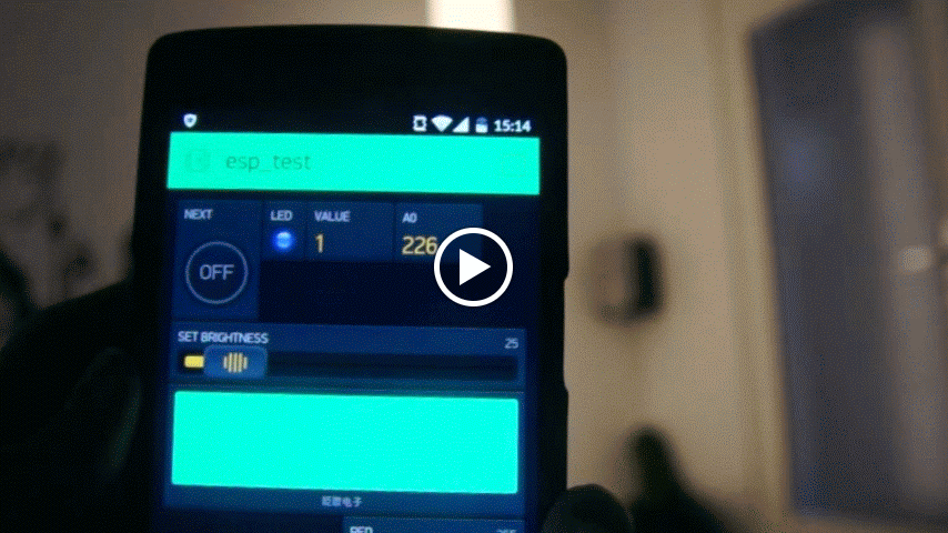

Today I want to show you my newest project. I have get this wonderful lamp where I installed a RGBW Strip of 744 (372 RGB/ 372 White) APA102 LEDs. They are controlled by a ESP8266 without a levelshifter. A levelshifter didn’t solved the problem. The ESP is running with 160Mhz. I played with the frames per second (I used 100)and The DataRate but I have always the same effect. My Problem is, that when I use very low RGB values (<10) and I have the fastled.setbrightness with 255 I have flickering of the whole stripe. Of I use high RGB values and choose with FAstled.setbrightness < 10 its working well with a very low brightness. Any ideas how to fox this? Any suggestions for this project? In the lamp are 6 stripes in a circly each is nearly 1,8m long. I used this app: http://www.blynk.cc/

No teensy is not supported. All data is send to a server in the Internet so you need an online connection. I don’t find it so good to send data to the Internet, but for testing some things quickly it’s good
