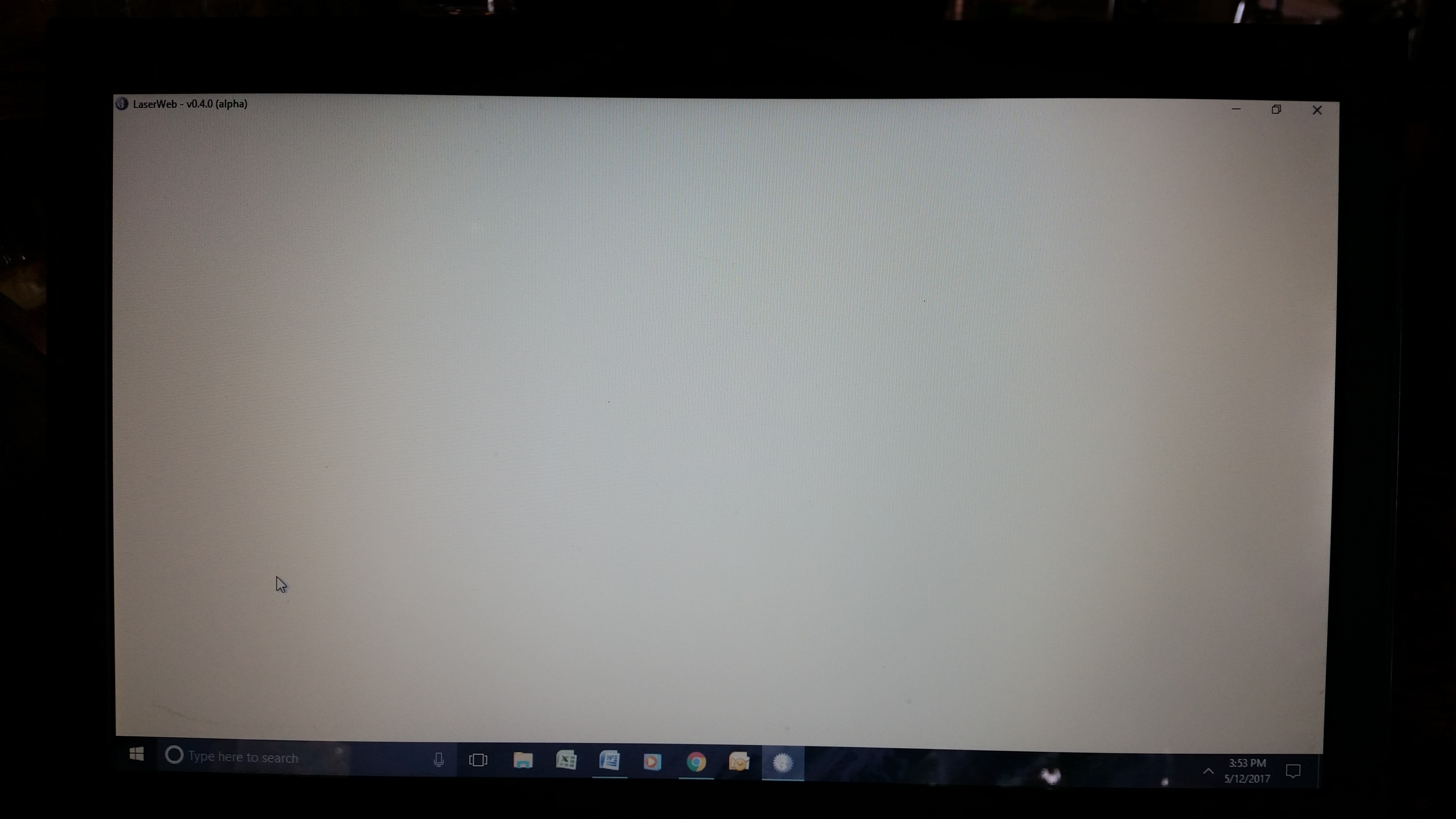

When I restarted the computer I tried to open LaserWeb and it will not open. It goes through part of the opening process and flashes the black boarder then goes to the white screen in the picture below and eventually it will, after 5 plus mins., let you click out (no messages). It’s only a problem on the LW screen, I can open up other screens and programs and they function fine… even when the LW screen is open and hung up.

No sorry you misunderstood, I loaded it in a win10 OS. I have two different laptops. The one I’m having this problem with is the Dell win10 and the pic I took was of its screen.
The original download ( .730) was working and is the one that first froze up and is continuing to hang up now on booting up the program ends up with the screen in the picture.
I deleted the program from the HD and reloaded (.731)it (x3) with this same thing happening.

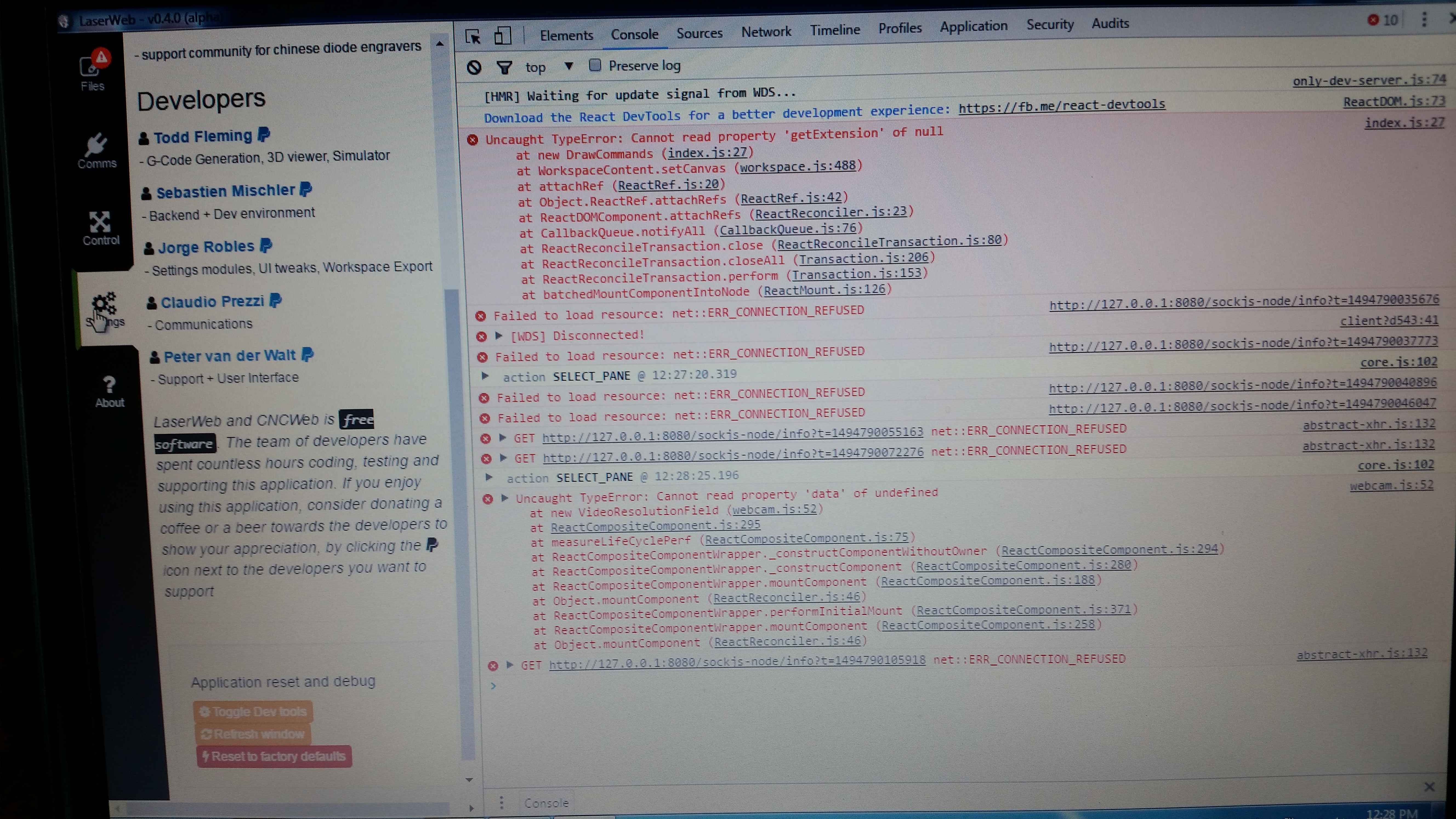

@Jorge_Robles Sorry I posts the errors on the wrong site. Here they are.
2nd pic
@Steve_Clark seems some is deep broken there. Those two screens imply there’s a WebGL error and VideoCapture service is not there (weird, probably a sideffect, 2nd pick was earlier than the first judging your clock :smiley: ) @Todd_Fleming
It definitely looks like WebGL failed to initialize. Can you try this site? https://www.shadertoy.com/view/XsBXWt
