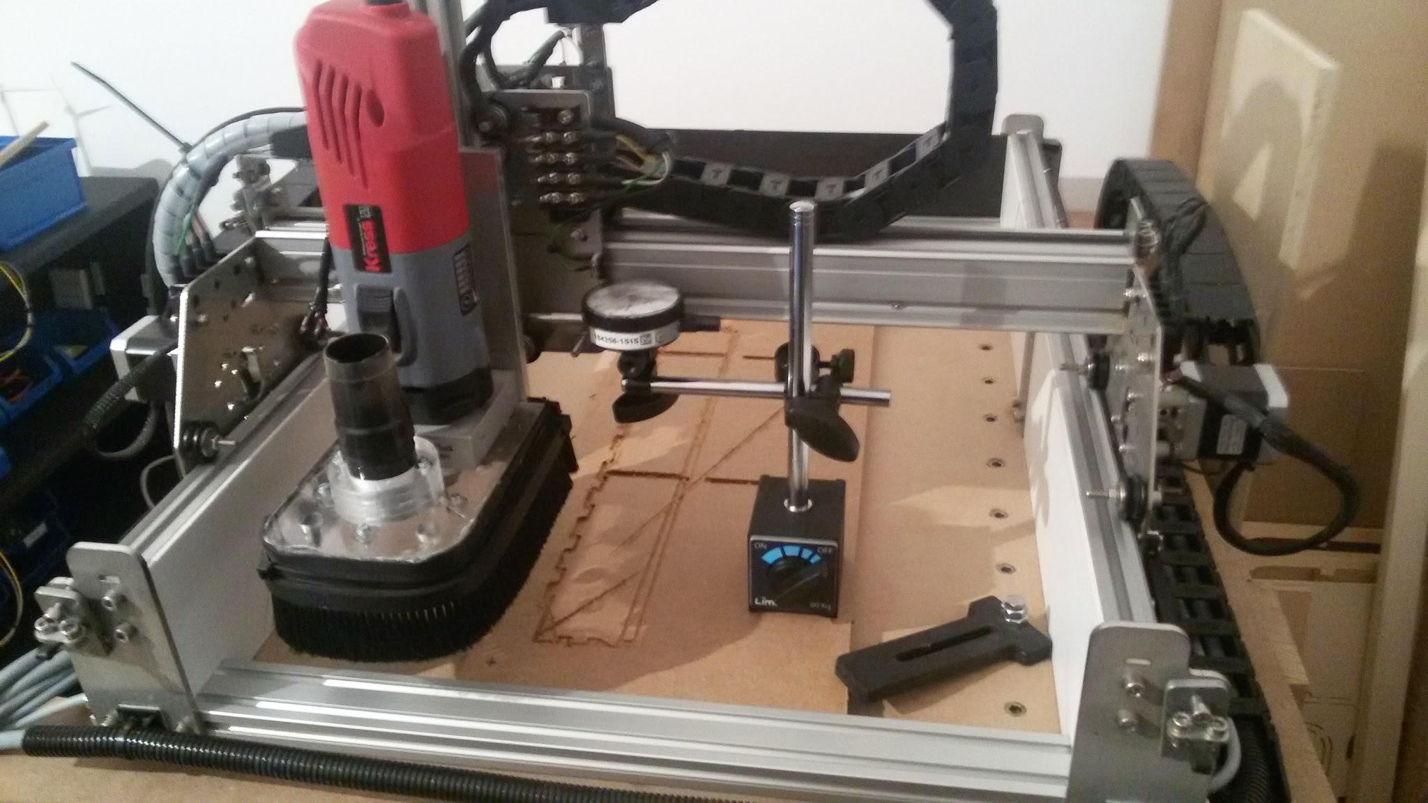

today is calibration day in my eshapeoko, i changein x and y axis my Travel per revolution from 36.54 to 35.92, my Z axis stay very nice
I found I had to do similar adjusted settings on my shapeoko after measurement and calibration. It always bothered me the measurements were so different than the mathematical numbers. On the new 3040 I have the measurements were exactly 4mm per revolution when I calibrated so the math and measurements were identical.
That is nice set up! Did u do the dust shoe??
yes but i have a new one in mind, i can share the design cad if you want. I want to make one smaller because this one take 10mm in each side of my x axis, i want also to put a camera and a few leds in new version, something like this: http://www.aliexpress.com/item/Smallest-webcam-module-small-size-hd-webcam-qq-mini-webcam-camera/977196231.html to use with chilipeppr
