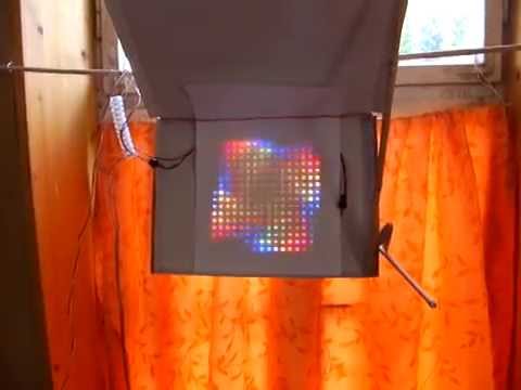

Today just some experiments with simple caleidoscopes,
Today just some experiments with simple caleidoscopes, @Mark_Kriegsman new wave functions and the usage of 2 CRGB arrays - one for the emitter/seed and one for the applied effect.
Code: Stefan Petrick - Pastebin.com
edit: Same code but different emitters Caleidoscope With Lissajous Emitters - YouTube
#FunkyClouds
Really interesting effects!
I like the thing of using multiple buffers and layers. Comes out great here.
Forgive me but I forget. Using a Teensy here?

By the way - exactly the same code as above - just with different (Lissajous) emitters with static colors: https://www.youtube.com/watch?v=8e3DDWnyEtE&feature=youtu.be
