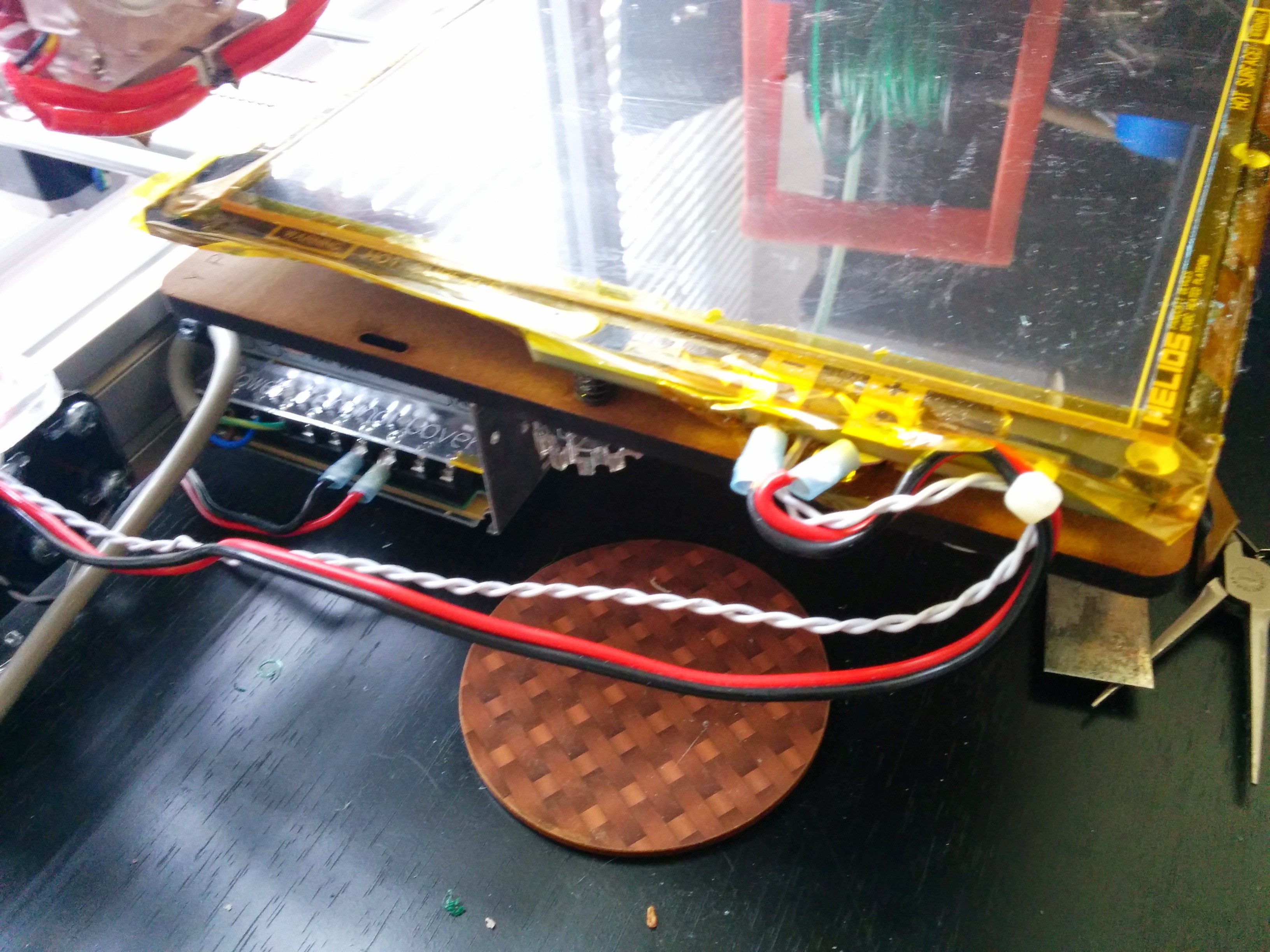

Today, realized the way I zip-tied the wires for the heated bed,
Today, realized the way I zip-tied the wires for the heated bed, make them rub against one of the posts that adjusts the bed height on one side. That side has always worked it’s way “loose” over time! Had to make a new path for the wires and take out all the slack to get them to reach a spot to zip-tie them on the other side, where they wouldn’t be able to touch the thumb screw.
