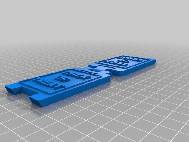

Today’s prints are tiny signs! My wife is going to use them at her
Today’s prints are tiny signs! My wife is going to use them at her work to show when computers are not working. They have a little built-in clip that holds them upright. I switched the filament partway through to get the black lettering printed on. I found out that I can execute a pause in the GCODE by inserting an ‘M0’ command before the layer I want to change colors on. Works much better than the ‘PauseatZ’ plugin that comes with Cura.
