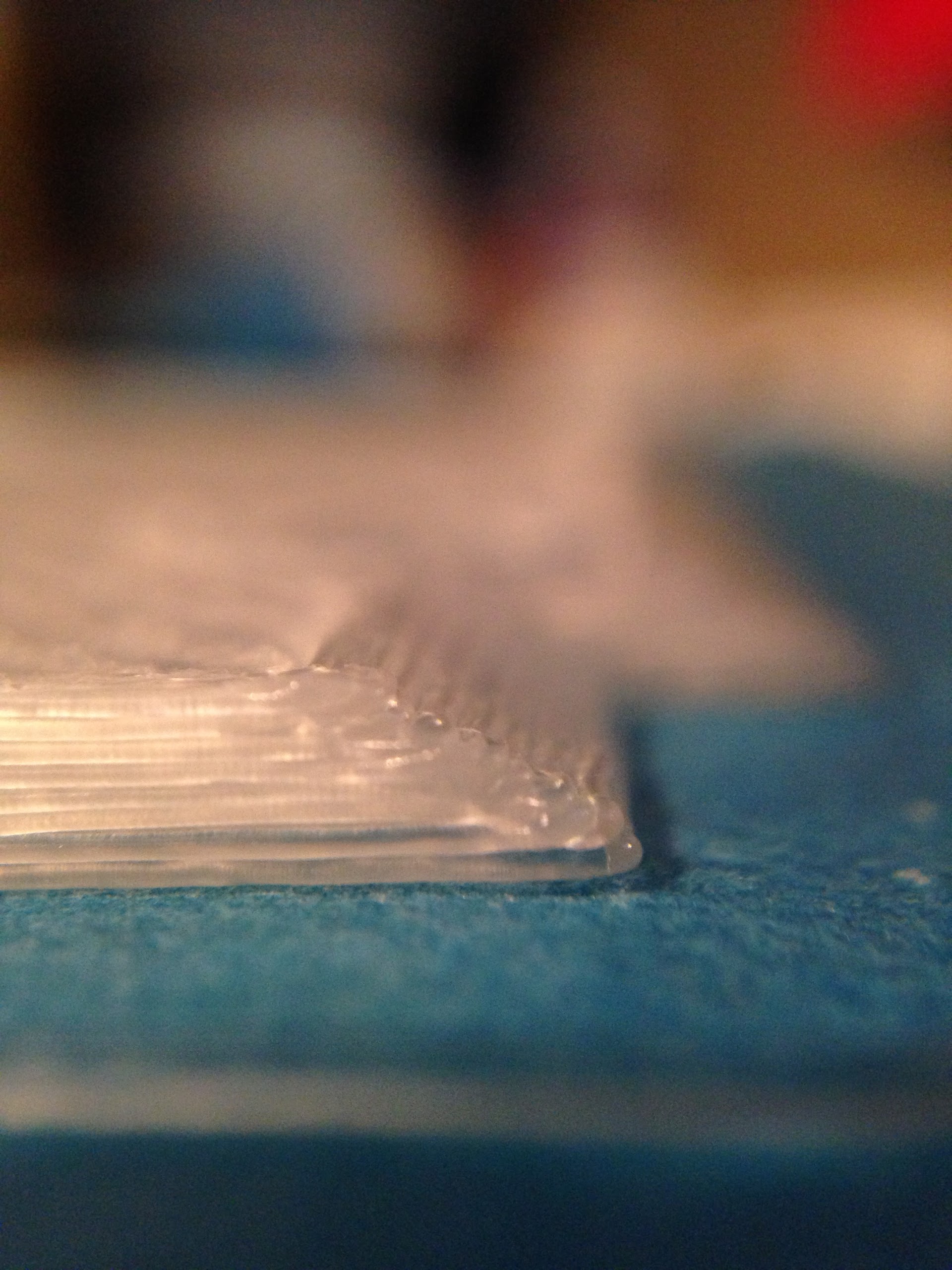

Today the fishing line ob my @Printrbot Simple broke. After mounting a new one I got a shift of layers on that axis. What should be a vertical edge is something like stairs…
Any suggestions?
Any suggestions?
Looks like you have slack on your new fishing line. Make sure it it really tight when you move your axis from one extend to the other.
And if it’s the braided stuff, it WILL stretch.
@Andre_Courchesne1 You’re right. Thougt I tightened ist enough. Now it’s better - thanks.
