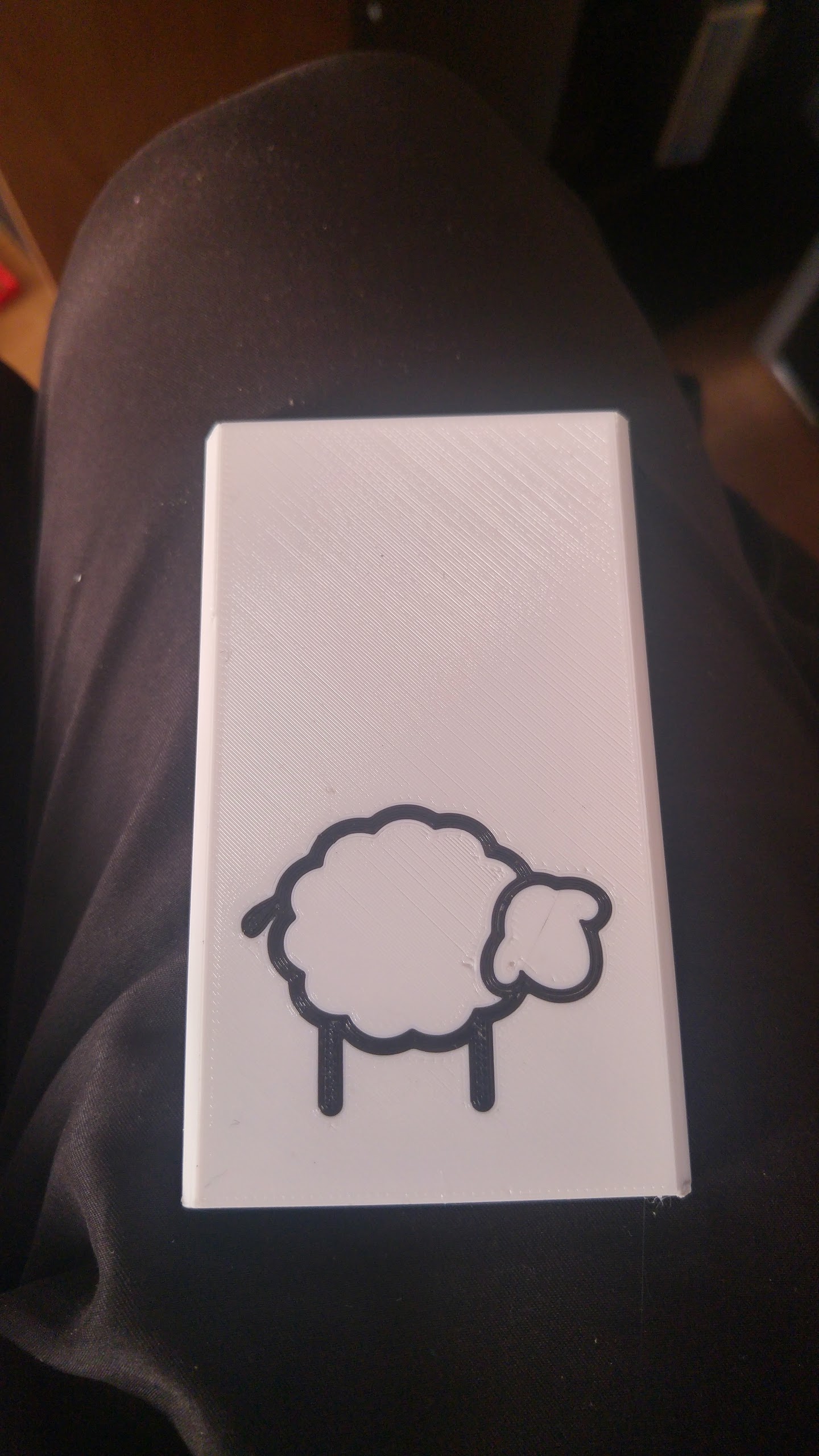

Today's triumph. Dual extrusion-style logo inlays without dual extrusion.
Today’s triumph. Dual extrusion-style logo inlays without dual extrusion. Admittedly, not the best print and not up to my usual standards, but that was my own fault for getting annoyed with one printer and swapping to another and not getting the bed properly level.
Looks good. I do this sometimes with swapping filament as soon as the walls are built. How did you do this?
Created a dual extrusion model as I would normally > Export STLs and import into S3D > use Dual extrusion wizard to group and combine the models then ungroup them, export the gcode separately for each part and then print one at a time, logo first.
