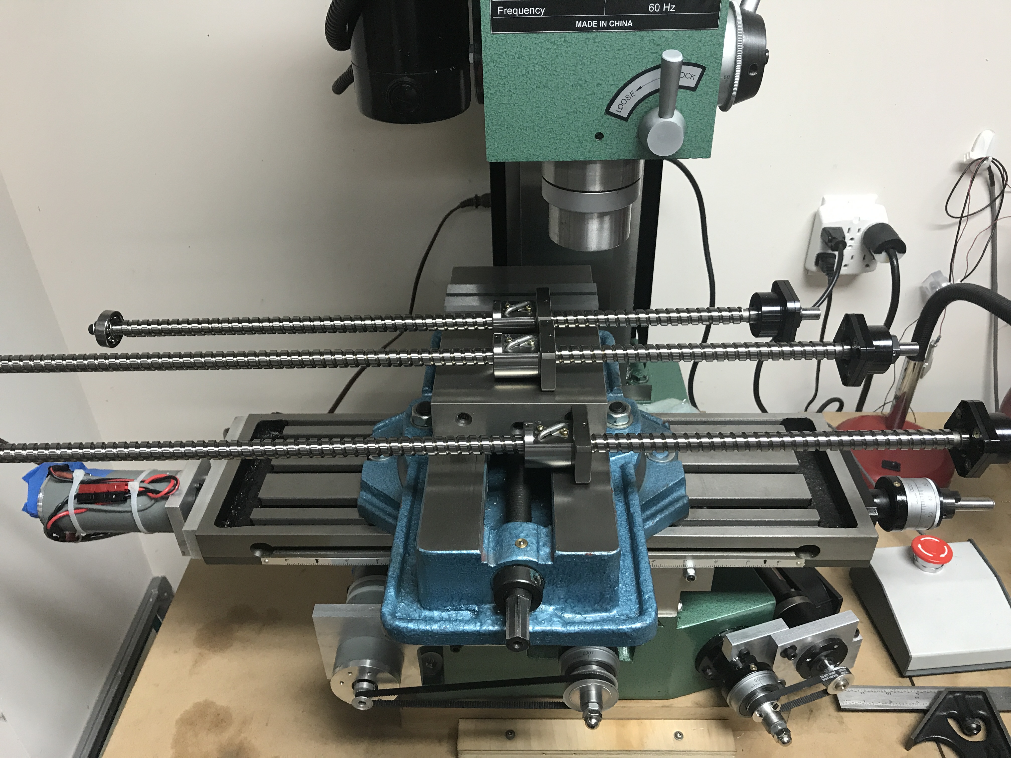

Took a long time searching eBay but found three matching NSK ground ballscrews for my mill. 10mm pitch, 14mm diameter. $260 for all three. More than I wanted to pay but they are in fine condition. Probably replace the brushed servo motors with some CMC brushless ones that I have at the same time. The ballscrews are longer than needed so will have to be cut down to size.

What brand of mill is that?
@Alex_Krause Seig X3 that I purchase about 13 years ago. It was cnc converted using the original acme leadscrews, servo motors, gecko320’s. My two other machines use ground NSK/THK ballscrews and always wanted to “fix” this one too.

Looks better than my machine Jim.
