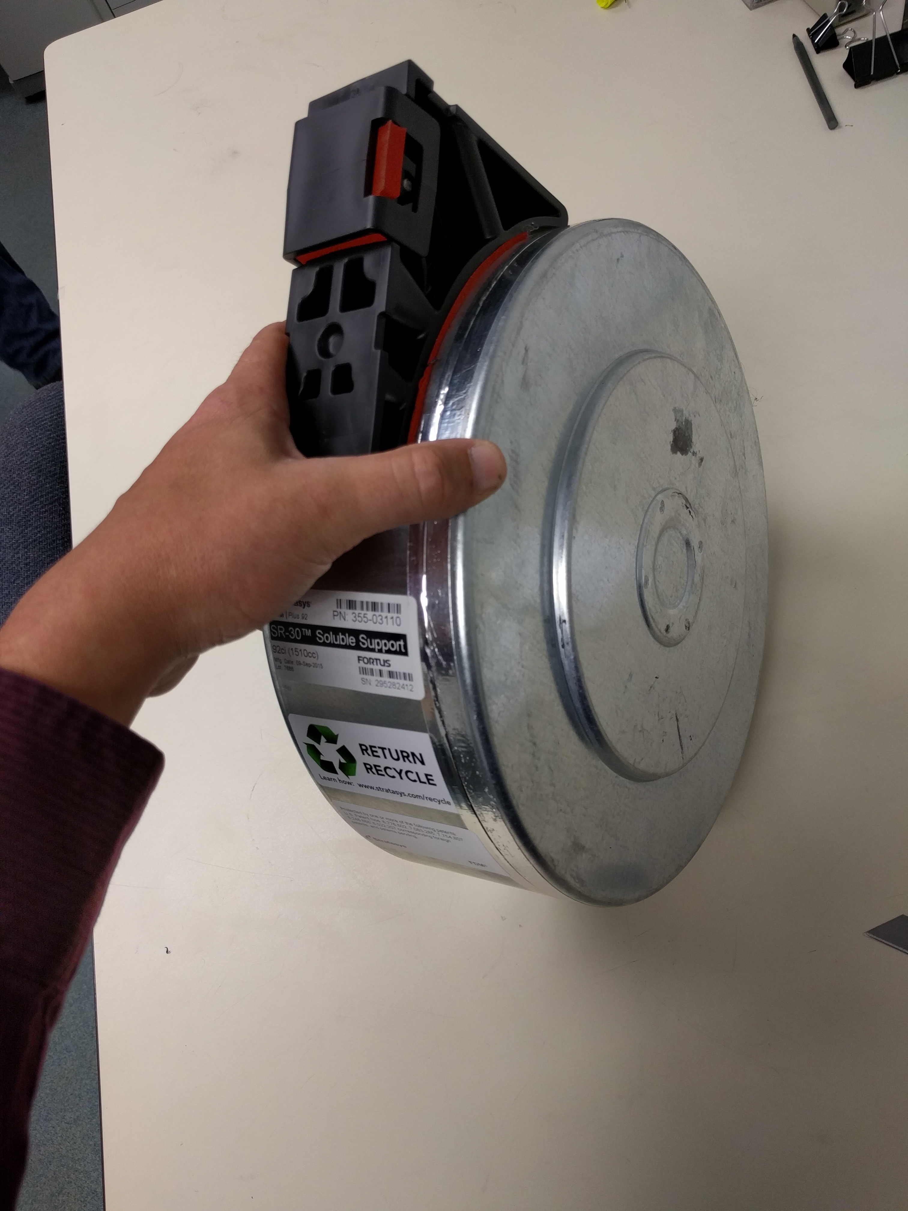

Took apart a few rolls of the Stratasys ABS-M30 and SR-30 support material that we use on the Fortus 450 if any one was interested. I thought it was a good idea how they pack the desiccant right in the roll, but surprised by how much material was left after they say it was at zero

Looking at the metal enclosure with something coming off the side, I though it was a cage fan at first. After that, I saw the other pictures. That seems like an expensive way to pack things.
i opened the cartridge of the Elite, it is similar but all plastic, sealed and yes there are 20m left when the roll is considered empty, this is because they calculate up to 10 changes and each change takes 2m.

That little (ptfe?) tube looks interesting, seems like it could decrease tangling?
@Peter_Hertel ​ I believe that is used as a guide into the head area
