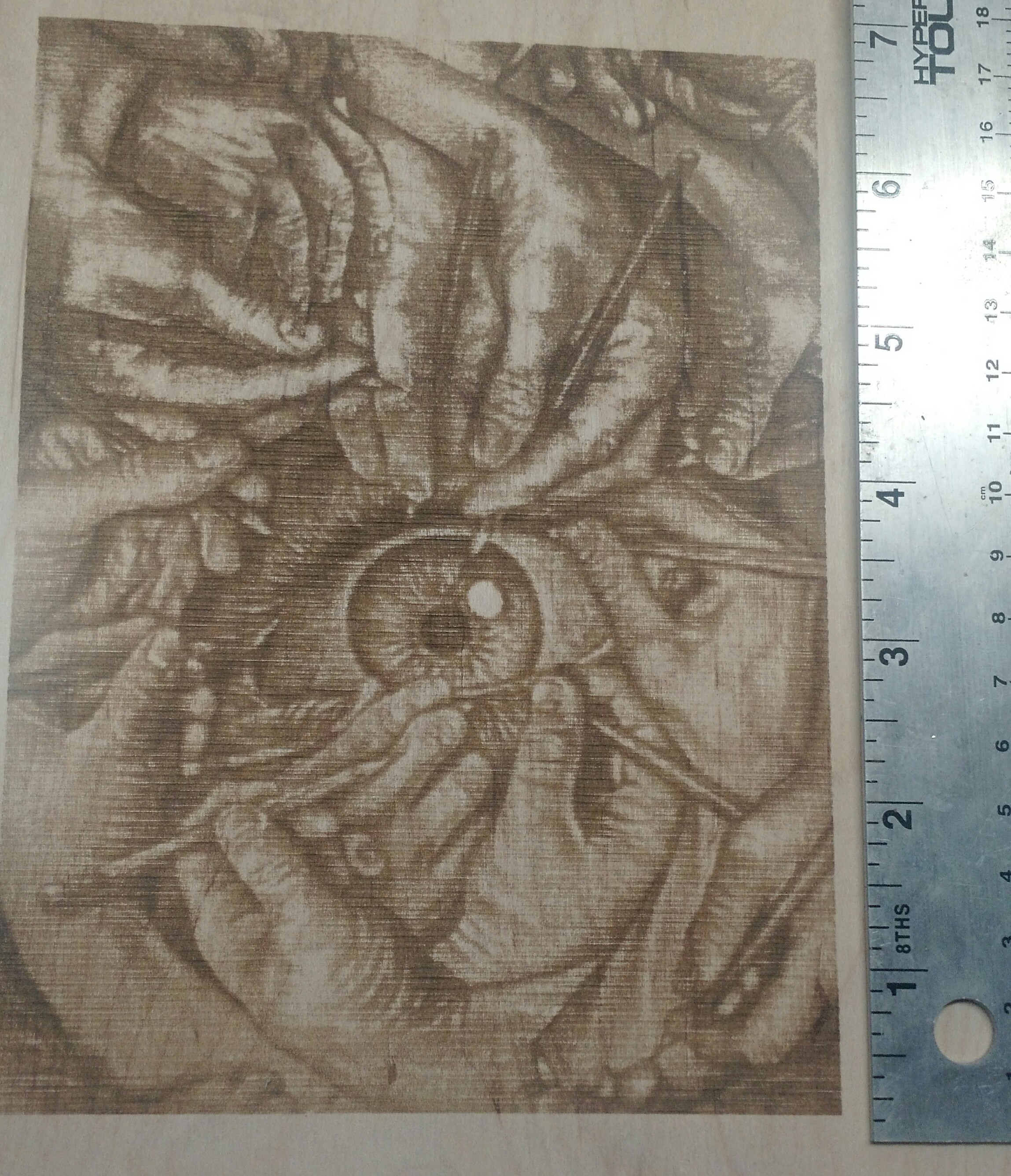

Took awhile to run… but it turned out pretty good
#laserweb #yearofthelaser
Nice work. Is this the million lines of gcode job?
Yep
Very nice work!
.1 dot size 400light 200dark on 1/4" maple ply 4-5mm closer to the laser out of focus
Forgot to mention… single pin pwm setup max Potentiometer output set to 12ma: laserweb power settings 1-99%
