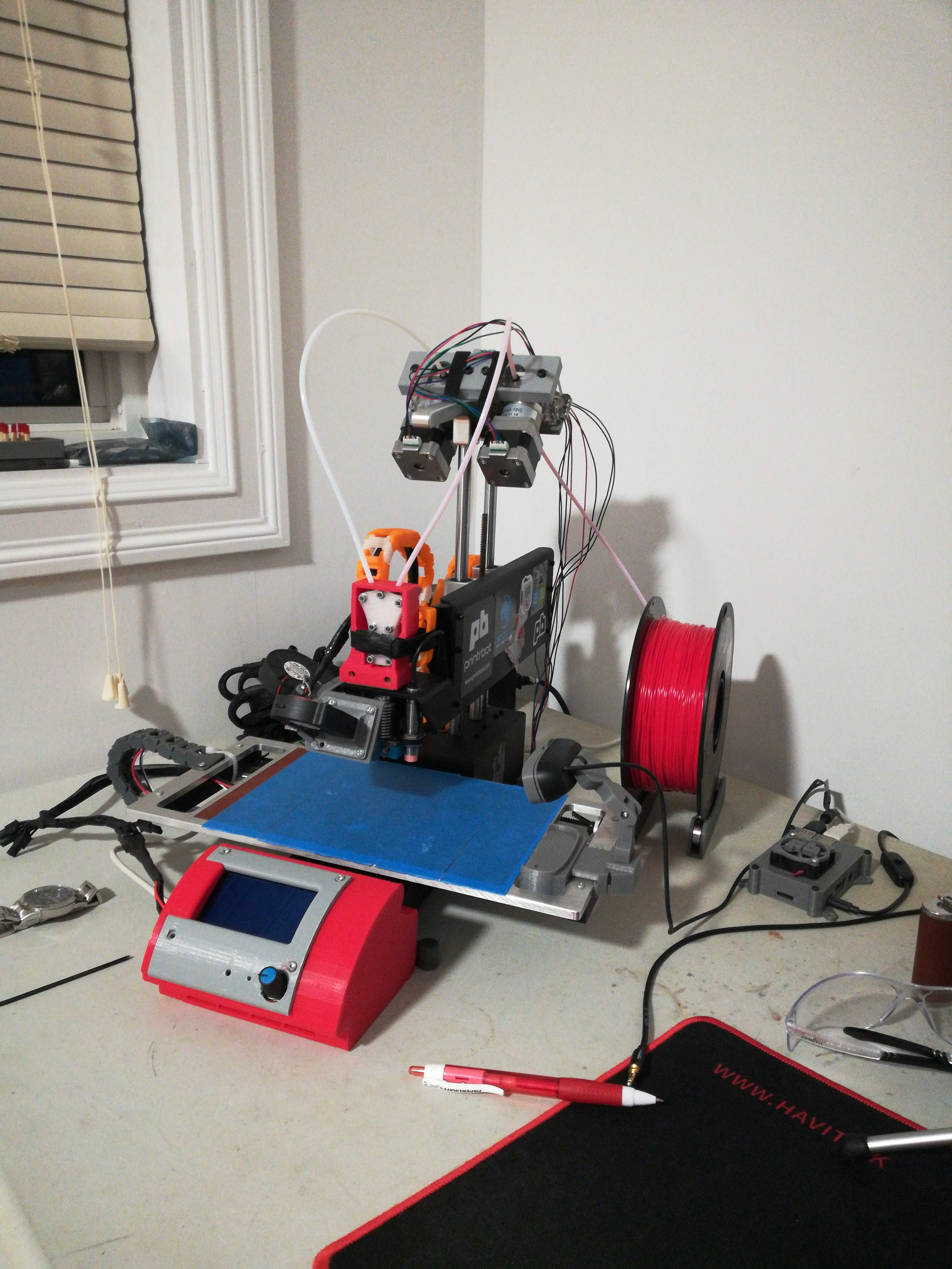

Took considerably longer than expected, but I have finally finished the upgrades to my simple metal. Printing calibration still needs to be done, but I’m well on my way to having a dual filament printer!
EDIT: list of what’s been done:
Extended x axis with headed bed
E3dv6 hotend with prometheuse system adapter
Prometheuse system
Dual blower fans
Printrboard to Ramps 1.4 (going to switch out the ramps eventually, but I wanted to get it running first)
