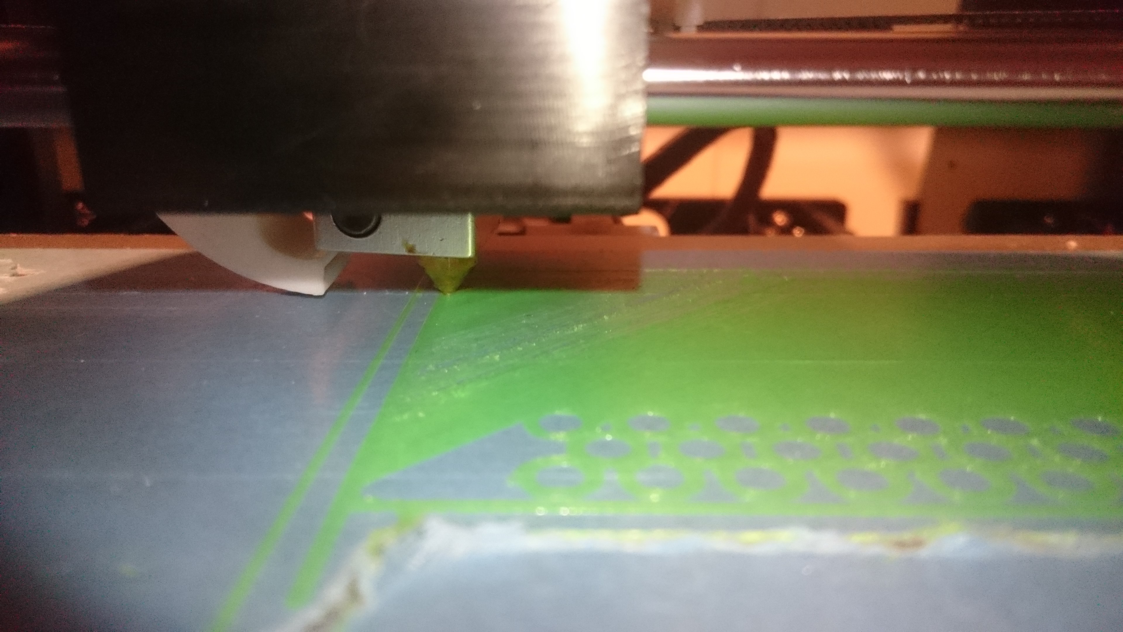

Took me some time, but managed to change filament on a 3d printer(anet a6) while it was still running! This was especially hard since my stock extruder is absolute crap when it comes to changing filament and my printer doesn’t go lower than 10% speed without commands.

All of these tips are great, but I was using cura 14.07, so I didn’t have a direct way of entering commands to the printer. This meant I would have to know when to change filament beforehand, which was impossible, since I just used a piece that snapped off my roll.
