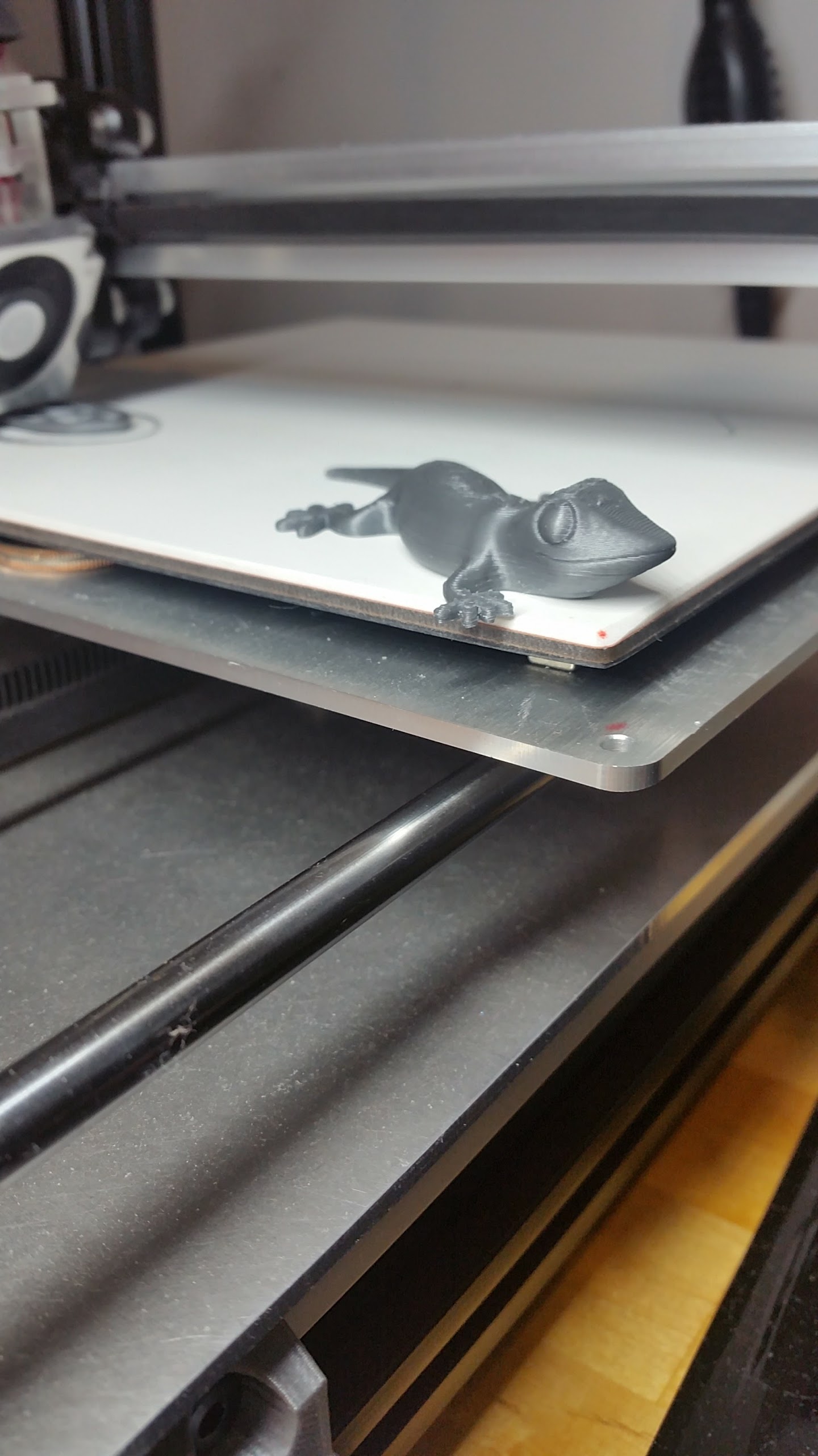

Top layers need some more tweaking. It looks rough at the moment.
Top layers need some more tweaking. It looks rough at the moment. Slower print speed at the top? Otherwise sides is really good I don’t see any rippling or ringing :+1: there’s quite a lot of stringing though. First time using Bowden here. Retraction was set to 5mm already. Is more than 5mm long retract normal for bowden?
More than 5mm in PLA would give you clogs as the hit filament would move to the “cold” zone. Try reducing temperature instead.
Step, I use for bowden 6,5mm and 100mm/s retraction with good results for PLA and PET-G. I have e3d v5 clone hotend.
Too much retraction and you’ll get under extrusion…
But I have very good prints…
What kind of extruder you are using?
100 seems high… I retract speed less than half of that… Maybe i should up my retract speed too
Extruder on Photo. Try higher speed. What kind of extruder do you use?
Just got E3D titan…

I think Terrence Tam did some experiments for the Kossel and found that 150-300mm/s retraction was ideal. I use 200mm/s and 6.5mm on a genuine E3D v6.
