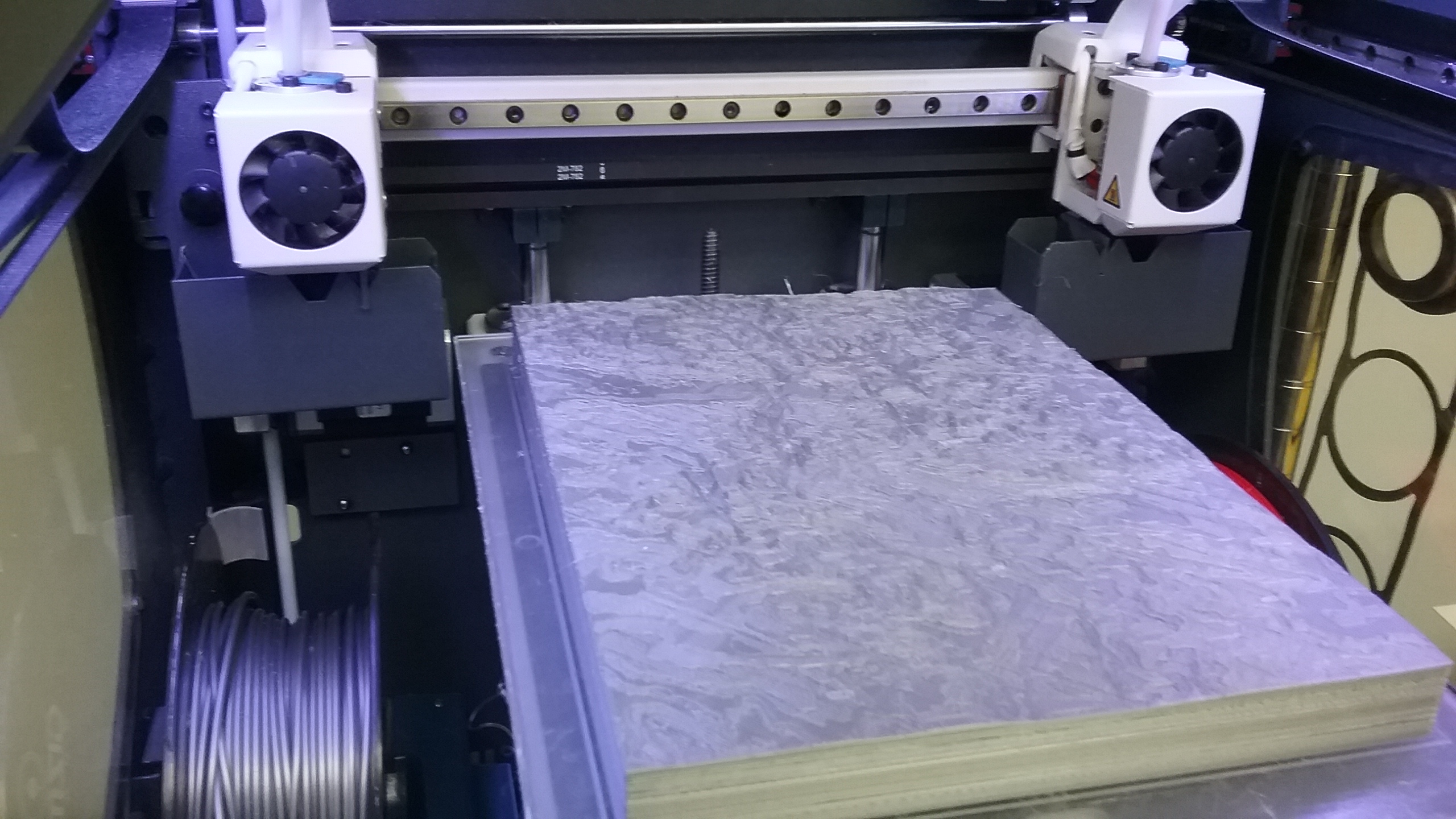

TOPO 3d print of the city of Morrison,
TOPO 3d print of the city of Morrison, Illinois on our new BCN3D Sigma
@Morrison_Institute_o it’s an interesting print, but why did you make the Z so thick, that’s an incredible waste of filament (and time). It doesn’t look like (from what I can see in the photo) that you’ve got any features for about the first 10mm at least of printing, why not slice the model so there’s only a couple of mm at the base before the detail begins printing, you’ll save yourself a ton of filament and probably halve (at least) the printing time.
