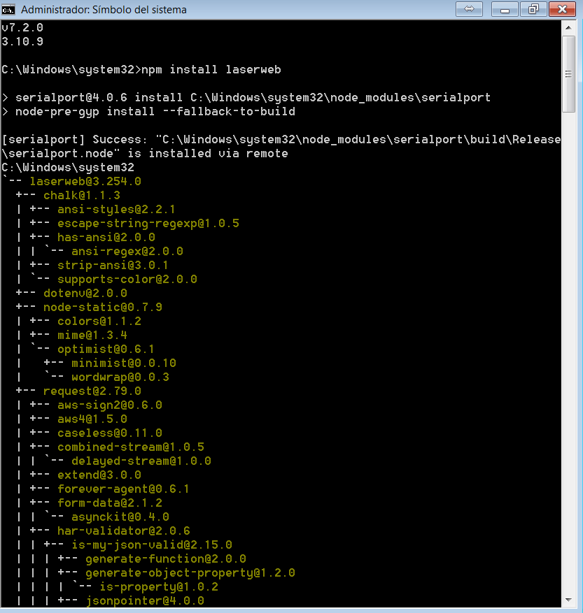

I have followed the wiki “Install: Using NPM install to simplify the process” (in windows 7 x64) but got a couple of warnings and can´t start the app.
I attached the output from the console.

You can do a “node -v” to check if node is correctly installed.
And you could also try the other installation method for windows with separate installation of node, git and pull laserweb.
Why are you instaling laserweb on Windows/system32?
Looks like it is looking for “server-grble.js”??? maybe check that “e” at the end before “.js”?
yesss it was a type mistake, I have revised the page, it should be: node server-grbl.js
Don’t worry, older Grbl versions are blocked now. Hint in red on log.
