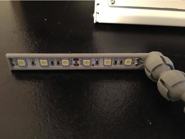

Ball and Socket LED Lamp
blue bomber shared this print on Thingiverse!
This is an updated version of the ball and socket LED lamp. The part that holds the LED strip is larger to accommodate strips whose sections measure 10mm x 50mm (5050). Two sections are used for this lamp so it is a strip that measures 10mm x 100mm in total.
Also, the part that holds the LED strip is larger than the MP Select Mini’s 120x120x120 print area, but you can tell your slicer that the x or y distance is 130 instead, and this will print just fine at 100%. Print without a raft, brim, or skirt. I do it all the time.
