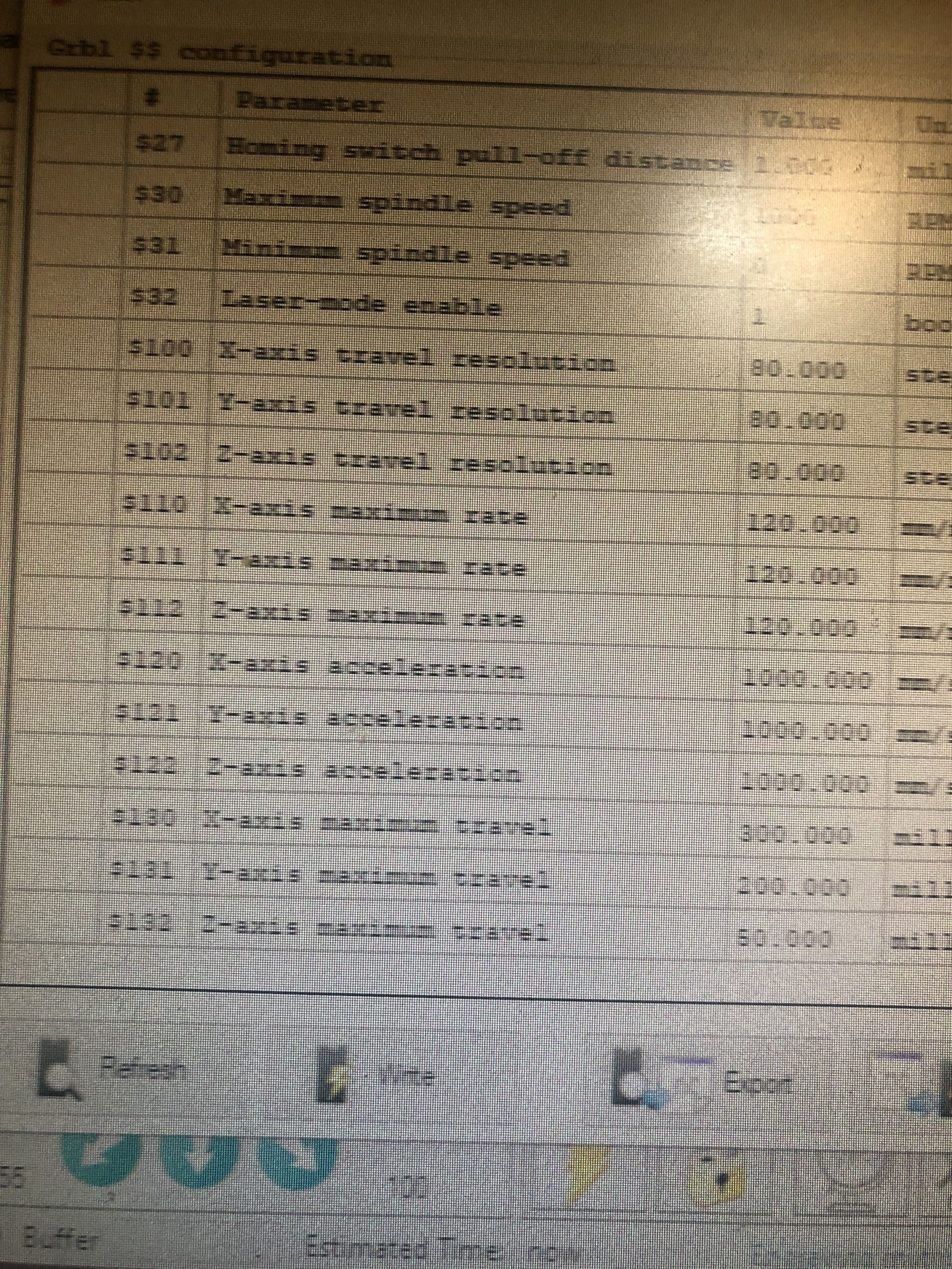

I am new. Just got my engraver yesterday. My husband messed with some setting because he was advised to from someone. Now my machine is all out of wack. How do I reset to default. Or find out the default settings. These are the settings he messed with.
Did your husband export the original settings before changing and writing the changes to the controller? If so then load the file and Write the changes to the controller/firmware.
If he did not save the original settings, I would save what you currently have and then try a reset. Reset by entering the following into the GRBL console input field(minus quotes) - $RST=$
Check to see if this changed anything.
