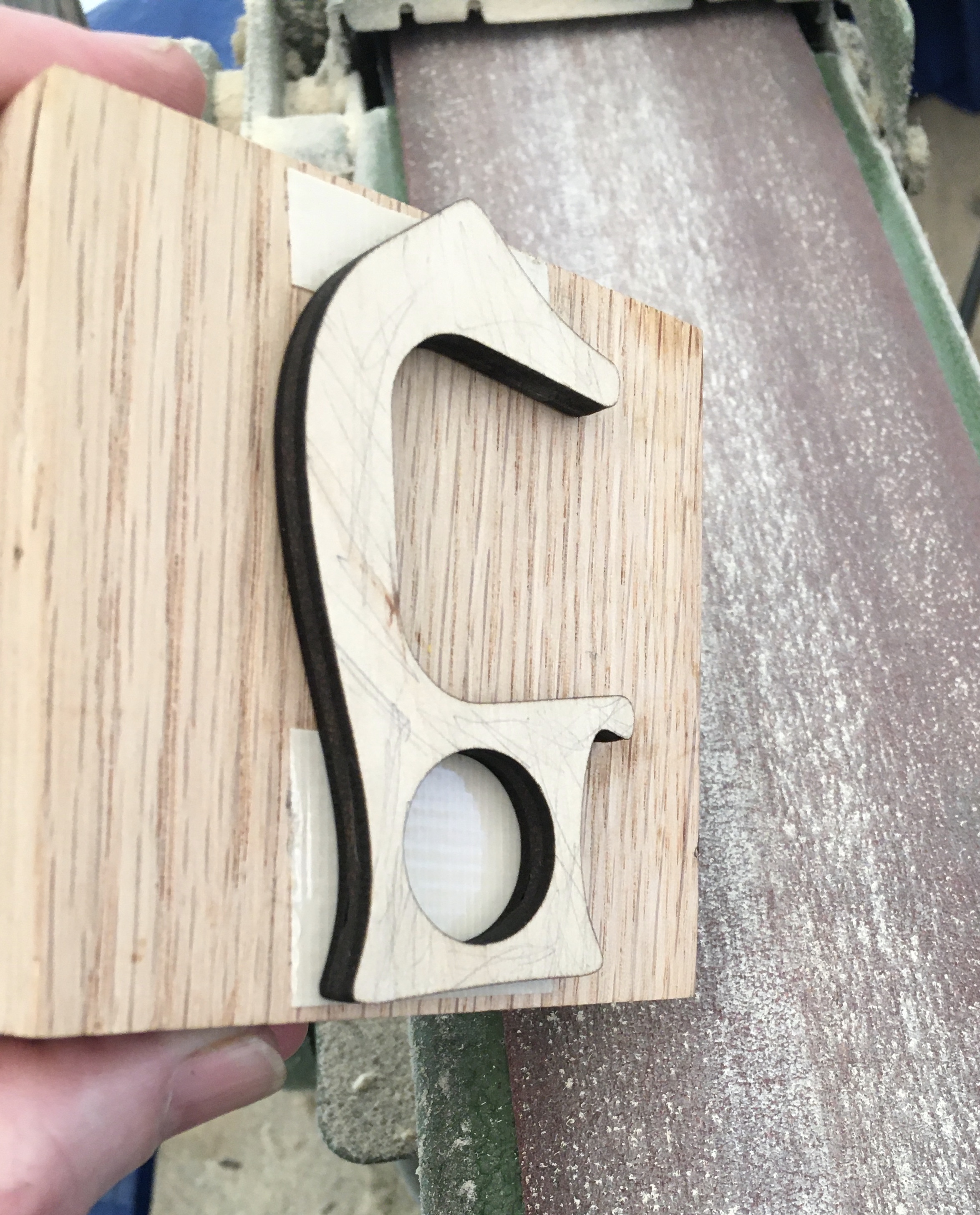

The Touch-inator and the spine of the sheath were cut from 1/4" plywood. The sheath sides were cut from 1/8" plywood. Prior to cutting, circles were etched deep enough to embed the magnets in the Touch-inator and one side of the sheath.
Attached the Touch-inator to a block of wood with double sided tape (magnet etched side down) and reduced the thickness of it by ~ 0.5-0.8 mm on my belt sander. This is necessary to allow for the thickness of the finish and allow the Touch-inator to slide freely into the sheath.

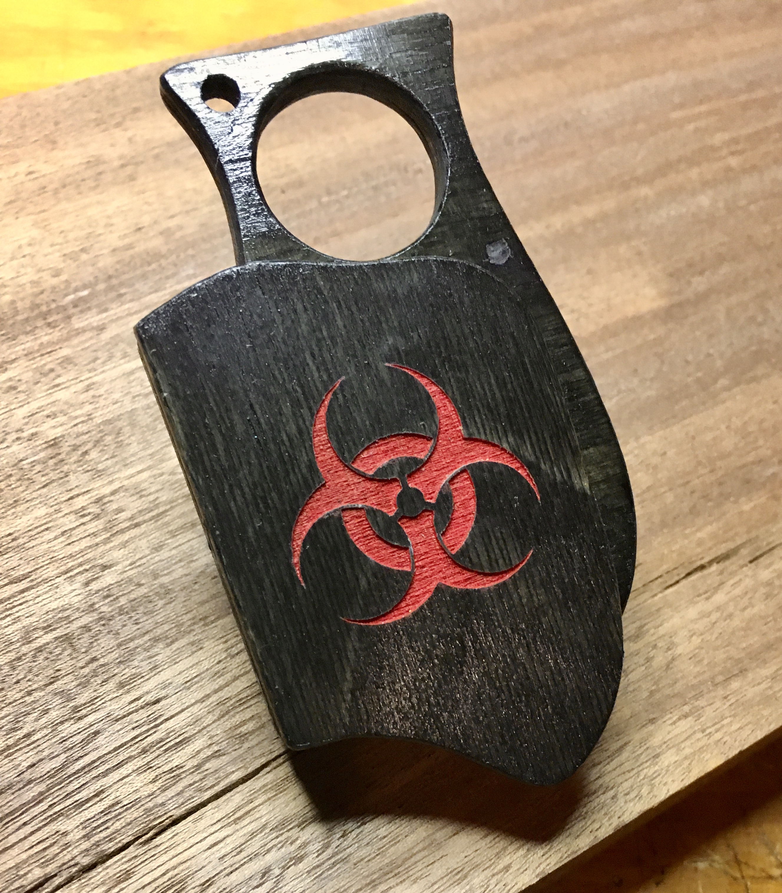

I chose to stain mine black, but it could be painted any color you want or left natural. For the finish I chose a gloss polyurethane spray. The polyurethane provides a tough finish that is relatively chemically resistant which makes cleaning / disinfecting easier. Applied several coats and allowed to cure overnight.
At this point I wanted to add a biohazard symbol. So I masked one side of the sheath, just be sure you are selecting the side that will be on the outside, and etched in the symbol. Used the piece of ply that I cut it from as a jig to make centering easy.
After etching, I painted the symbol red and removed the masking.
I used a 3x1.5mm magnet on the Touch-inator and a 6x1.5mm magnet on the inside of the sheath. I used 2 double stacked 3mm magnets because it turns out that the 6mm is a bit too big to fit the overlap of the sheath side and the next size down I had was the 3mm. One 3mm by itself was not quite enough holding so that’s why I doubled up. A 4mm diameter would probably be better. I sized the holes I etched for the magnets to be a press fit and at this point I added the magnets, making sure they were oriented correctly. It’s possible that another set of magnets will need to be added at the tip to improve retention.
