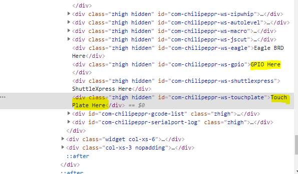

Ok, the problem is that the old JSFiddle version of the Touch Plate widget is still in the code. I’m not sure that ever got ported to Github. JSFiddle keeps getting updated and some URL’s get broken along the way.
This is the method I see in JPadie’s code that tries to load Jarrett’s widget, so two other contributors code here. You could go try to port that JSFiddle to Github, which is akin to just moving files from JSFiddle to Github, then do a pull request to JPadie on Github.

looks like the problem is here, but dont know how to fix
