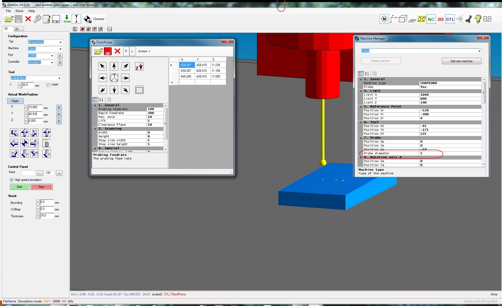

I don’t know if I understood your question correctly.
The functions you can perform in the Probe Dialog assume that you are using a ball probe. You can enter the diameter of the probe ball in the MachineManager. (See attached pic )
If you want to consider the thickness of the plate (e.g. 4mm) in the macro, you can do this in the command G10 L20 p1 X0 Y0 Z4
