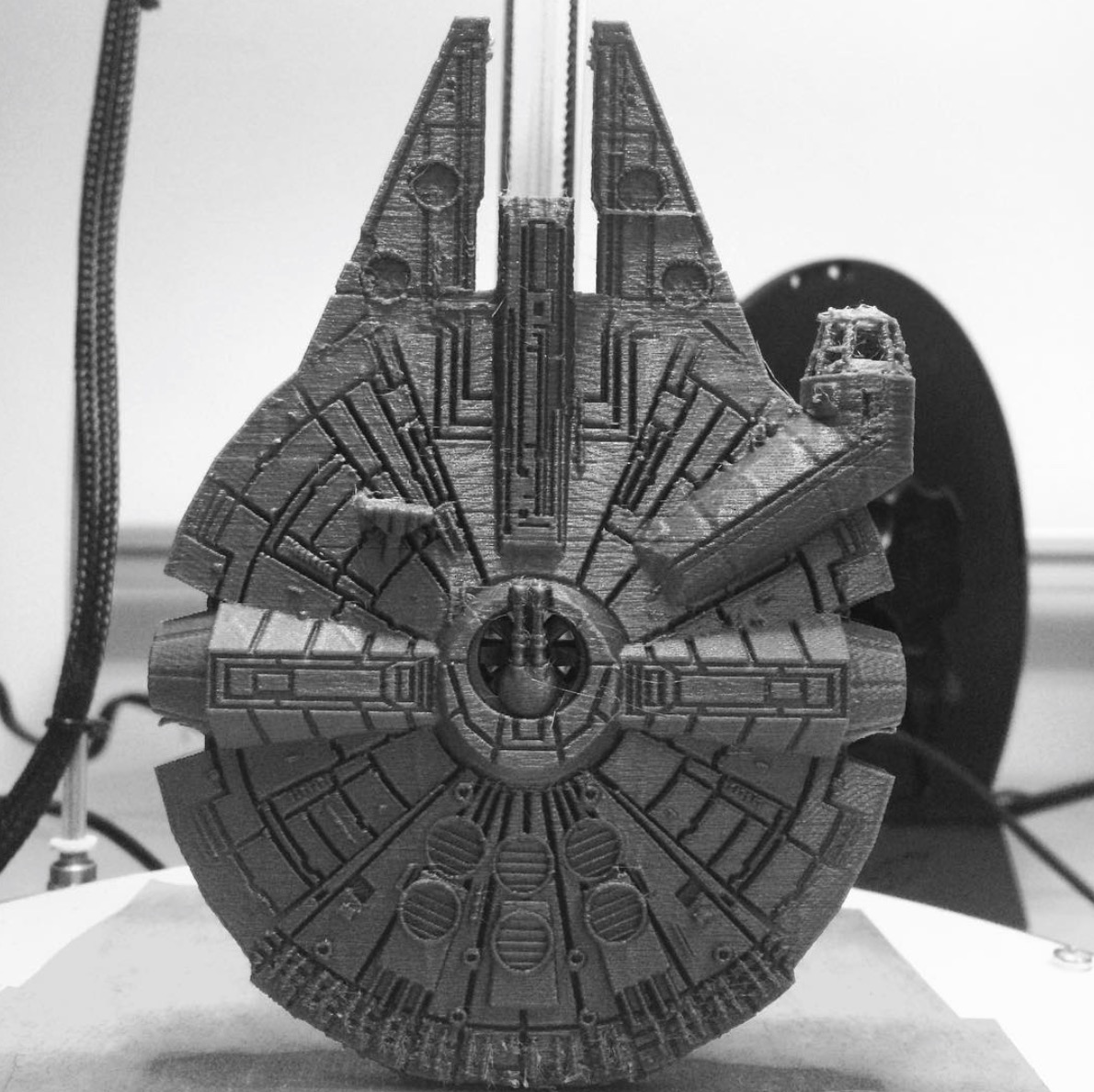

Tough print! Scaled down to 60% and still managed to get all those details
Tough print! Scaled down to 60% and still managed to get all those details in. Printed with PLA at 0.15mm layer height on the Delta Go. Took about 10 hours. The top started to wobble a bit even with z hop and raft enabled since the base barely had any contact with the raft. No supports.

What’s temp, retraction speed & distance settings?
Tks
210 Celsius, 40mm/sec, Cura
@Shai_Schechter , thanks, what about retraction distance?
@Ivan_Hoe 2mm retraction at 50 mm/sec
