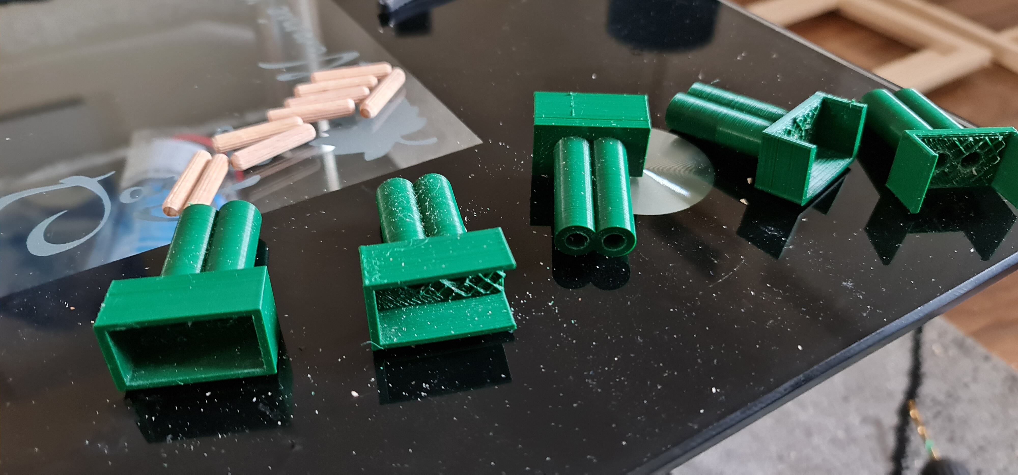

I 3D printed some dowel jigs :
All different configurations to allow drilling into the end of the battern, or side etc :
