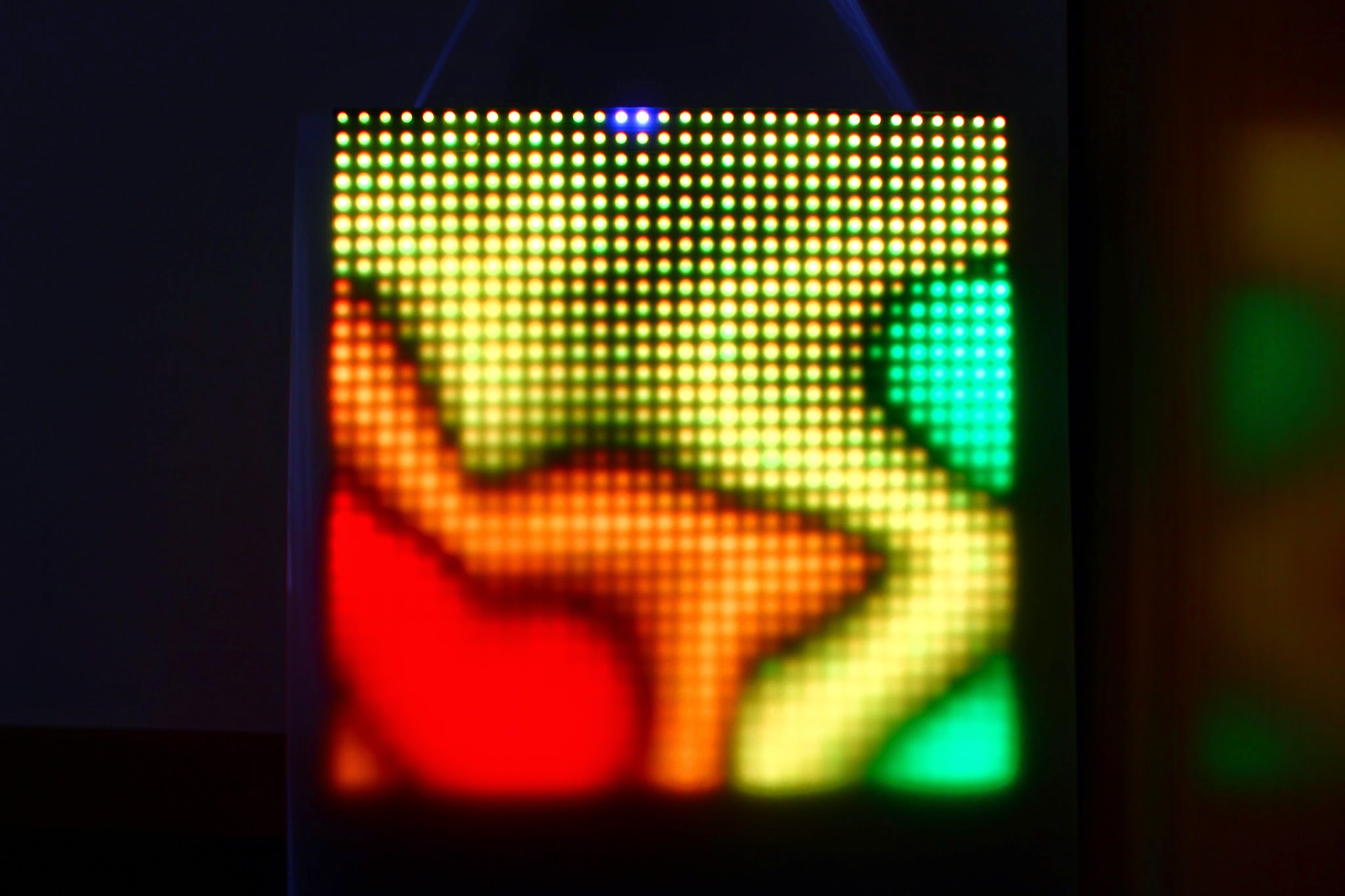

Translum diffusion again. What you see on the (focussed) photo is a cheap dull plastic sheet protector in front of the matrix. At the top with no distance between the leds and the plastic, at the bottom with 1.5 cm distance to the leds. Just saying.
It’s not the plastic you use, it’s how you use it!
Well, the surface of the plastic matters, too. With flat reflecting stuff it doesn´t work. It is the dull surface that does the trick.

@Mark_Kriegsman I remember that I offered you guys a sample of that Translum stuff awhile back. It turns out that the stuff I dug into wasn’t the right stuff. I ended up taking material that my pop’s uses for his photography business, oops! So, I can attest that the Translum, will give you delicious diffusion at a very small distance from the LED’s.
Oh, and another note, hopefully @Stefan_Petrick will agree, the translum plastic is very fragile. If bent too much (which isn’t much), it leaves a milky white line at the crease and is horribly unsettling when gazed upon.
I agree absolutely. It is more a meditation than a job to handle that material properly. Gloves are also recommended as it picks up everything it gets in contact with…
