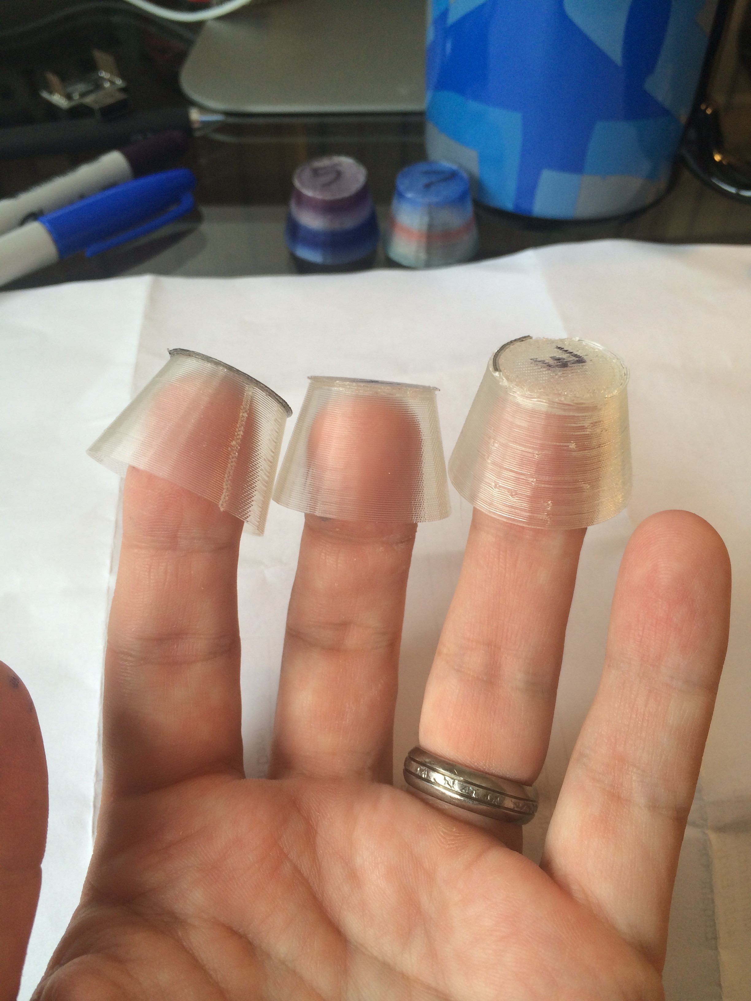

Transparency tests: Using Natural PLA. From left to right: 1) single shell.
Transparency tests:
  1. single shell.
  2. single shell, vase mode
  3. double shell
Findings: single shell is stronger than I expected. Double shell is still somewhat translucent.
Conclusion: natural PLA could be used as light diffusers.

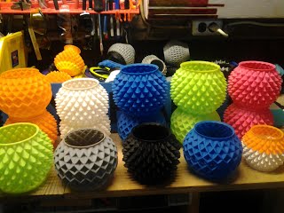

@Joshua_Marinacci I made some in 123d I call it shark tooth. No infill, no top 4 bottom , it makes a good shell at 2 perimeter
Are they half spheres? I’ve done half spheres with the open end at the bed. The edges are fine but it falls thorough at the too of the dome.
Duckon?
Woah. That’s awesome!
Can you send me a pic of your spheres?
When you say ‘spheres’ do you mean the round spikey vases? Do you have STL models you can share?
Ya the spike globes and their inverse are my best prints. The sharktooth is mostly pure globe but tooth pattern cut in. I will maybe upload to thiniverse and share.

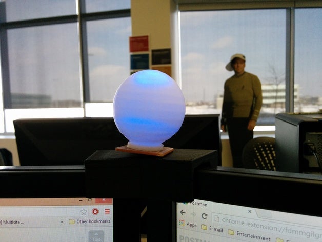

not mine but here is globe on thingiverse.
