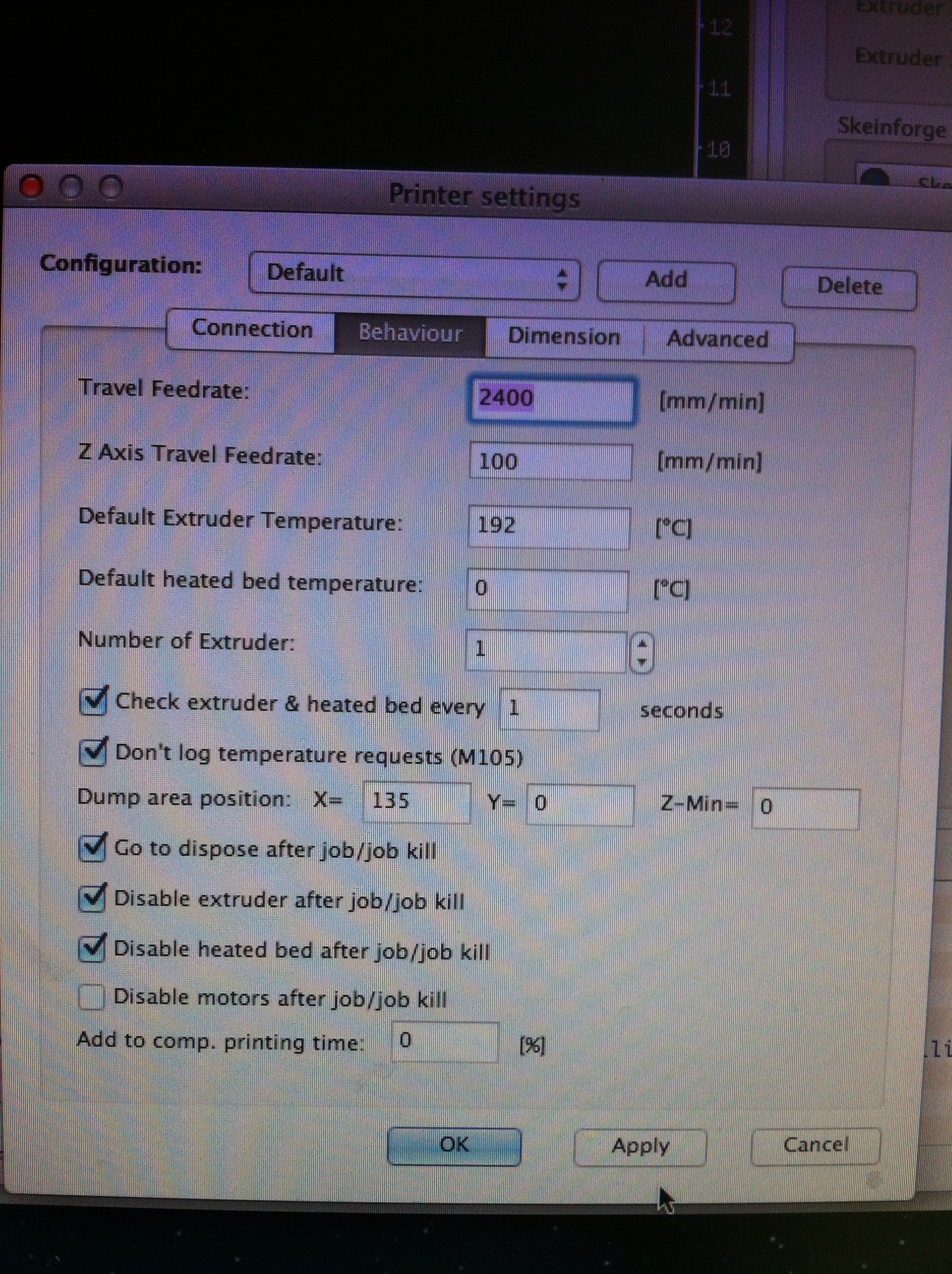

Travel feedrate. This is the default setting which I have been using in Repetier
Travel feedrate. This is the default setting which I have been using in Repetier since I first got my bot. Is this standard and what does it really indicate?
The travel feedrate describes the speed the printer uses for moving the printhead from one printing area to the next. It is additionally limited by your firmware, so whichever value you enter there will be used as long as the firmware thinks it can handle it. It should be set as high as possible (mitigates oozing), but not so high that your bot starts to skip steps during long travel moves.
And it’s kind of non-standard for it to be in minutes. Usually it’s mm/s - which 2400mm/min is 40mm/s - which is REALLY slow. Most bots have a travel speed of 100mm/s (6000mm/min in this case). Travel feedrate is ok, but I’m usually hitting 240mm/min (4mm/s) – it depends on your thread pitch how fast you can go.
Alright. Thanks. Starting to understand some of these numbers and setting a bit better now. Now I need to figure out why Repetier lists EEPROM settings in the drop down but won’t allow me to select it. I was hoping to be able to change the z-steps here, instead of having to mess with firmware
@boog_nish You wont be able to change them if the eeprom feature is disabled in your firmware. It’s somewhere in the config.h file in Marlin.
Sorta like Thomas said, Travel Feed Rate is the X/Y speed when the extruder is off. Feed Rate is the X/Y speed when it’s on.
mm/minute is pretty much the standard units in gcode files. When people talk/type about rates, we use mm/s. Probably because it’s easier to visualize.
