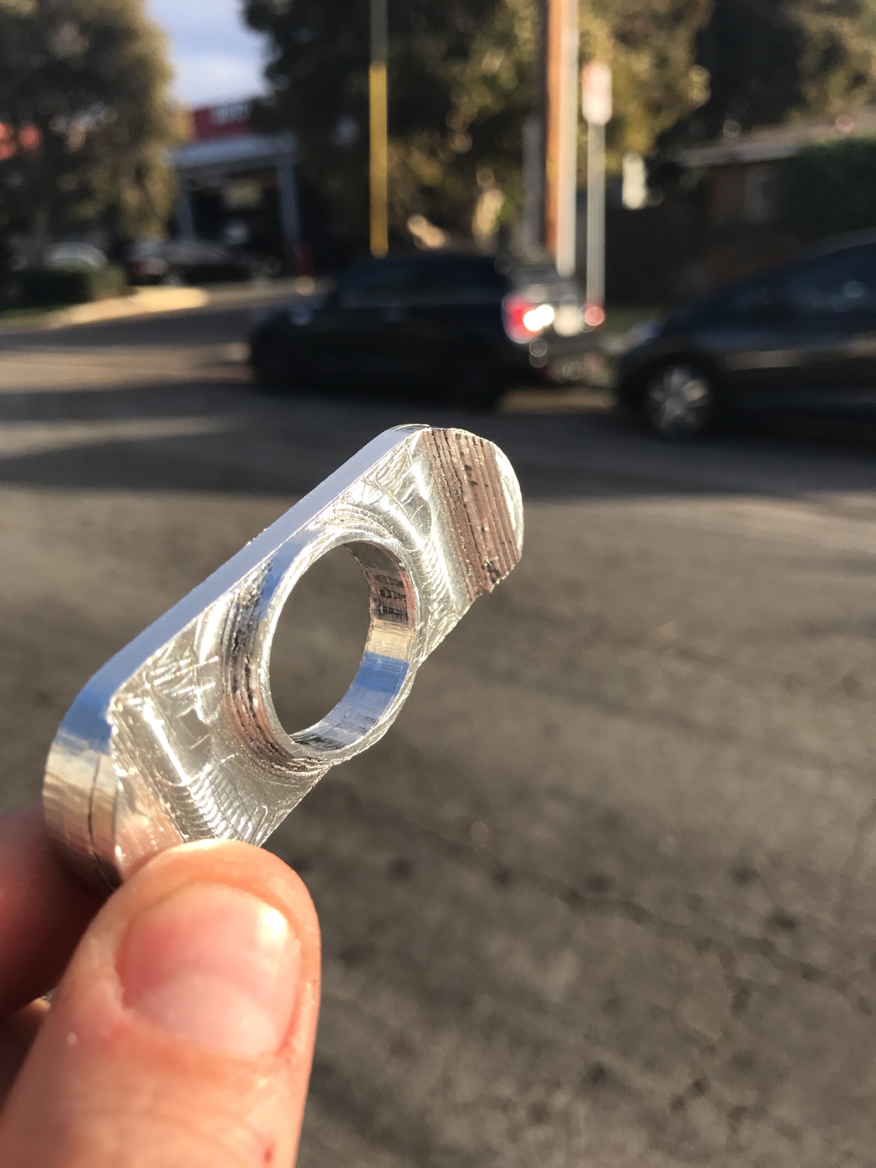

Trial 2! Thanks for all the advicr! Dimensions are accurate! Had to stop it
Trial 2! Thanks for all the advicr! Dimensions are accurate! Had to stop it at last path of .1mm because I noticed the piece was vibrating (need to ad tabs next time)
Progress! That’s great.
Is that chatter on the low surface near his thumb?
Not trying to spoil his accomplishment, just asking. I know just enough to be dangerous.
I don’t think it’s chatter the machine isn’t making that sound. It’s weird. Fushion360 didn’t do a finish all the way across or a second finishing pass
@Derek_Schuetz
You should simulate before machining to check for errors. CNC is great once it is all setup, but before then it can be as much of a hassle as anything else is. You have to just keep plugging away at the post processing, until you get a file that runs right.
