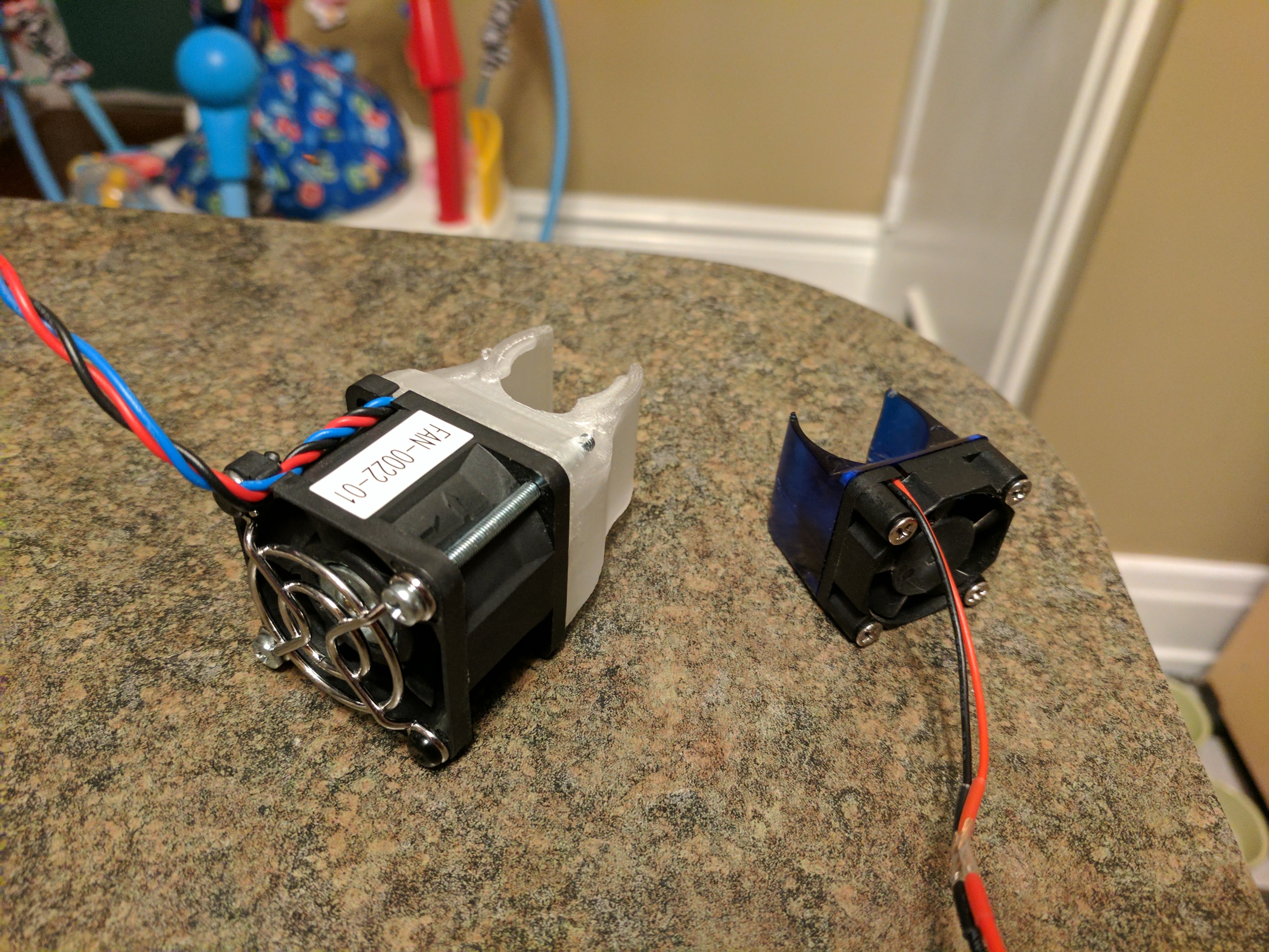

My experience is pretty much identical to what @michael_hillpot is describing. I just installed a high flow 40mm fan to see if that helps. When I pull out the jammed filament, the end has a slightly larger diameter than the rest, as if its getting soft higher than it should (heat creep). At least, that’s what I’m hoping is happening.

I was able to finish a print last night (no jams). It was only about 2 hrs long, but this print had previously failed every attempt. I swapped the 30mm fan for a high flow 40mm fan. It looks absurd, but it seemed to do the trick. More testing to follow.
I have been meaning to follow up on this. The high flow fan screwed with my PID settings and I kept getting false thermal runaway errors, so I switched back. I took @Joe_Walters advice and got an E3D Lite 6 heatsink, which uses has the bowden tube extend all the way down through to the nozzle, so no heatbreak (well, its built in to the heatsink). I have had much success since then. So it seems the trick is to use a hotend with a PTFE liner.
