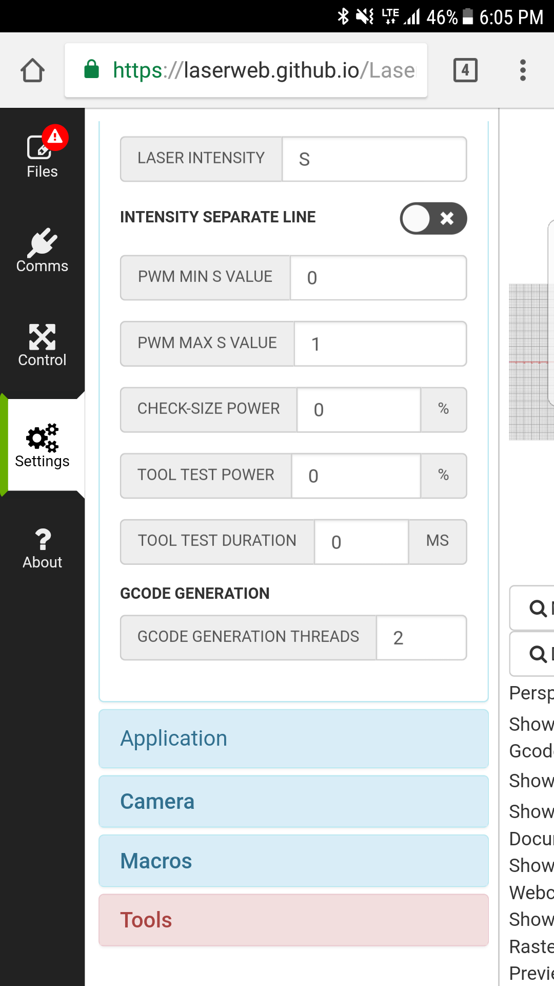

Try increasing gcode generation threads
@Ariel_Yahni_UniKpty Ok, I changed it to 4 threads, it didn’t appear to make any difference. In task manager there is one laserweb.exe that used up to 40% cpu, and 2 other laserweb.exe that show 0% use. The file still took 8 minutes to create a path. Most of the time its just stuck at 25% on the main process.
