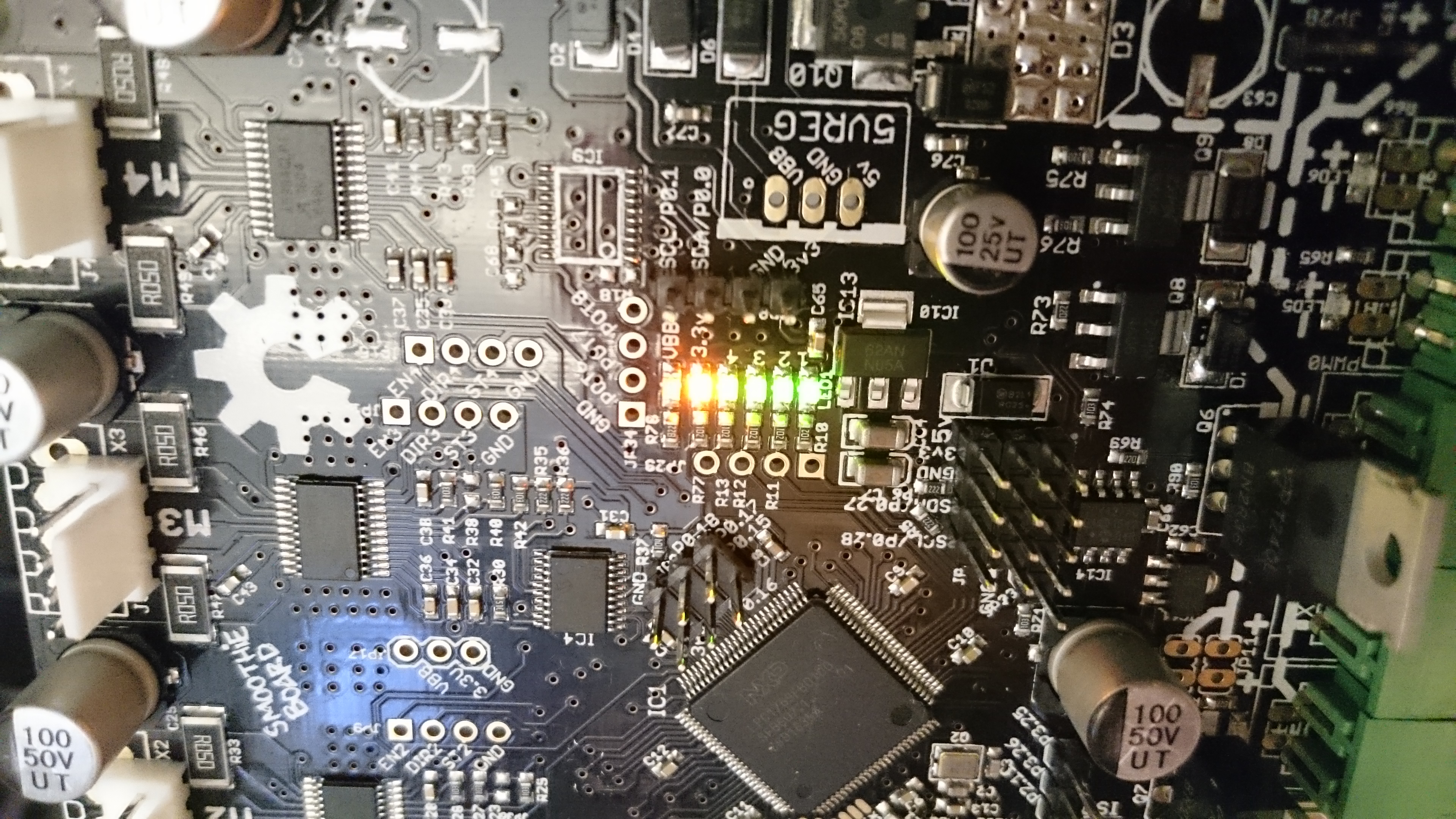

Troubleshooting: I just got my smoothie board today and am experiencing issues. When I plug the board into USB (and nothing else), my computer cant find the SD card. Four LEDS are on solid: 1-4 and 3.3V.
Any ideas on how to fix this? I think normal operation my computer is supposed to find the device and allow me access to the SD card.

Hi all I think I fixed it. Seems like the firmware on the SD card was bad. I cleared all the files and downloaded a fresh .bin from github. Now the board connects and lights blink. Thanks!
@Jamison_Go When a firmware.bin file is present on the SD card, the board flashes it automatically. We ship the boards with a firmware.bin file on the SD card, which means the very first time you plug it in, it flashes that file. If you unplug it too early the first time you plug it in, that process can get messed up, which looks like what happened to you.
