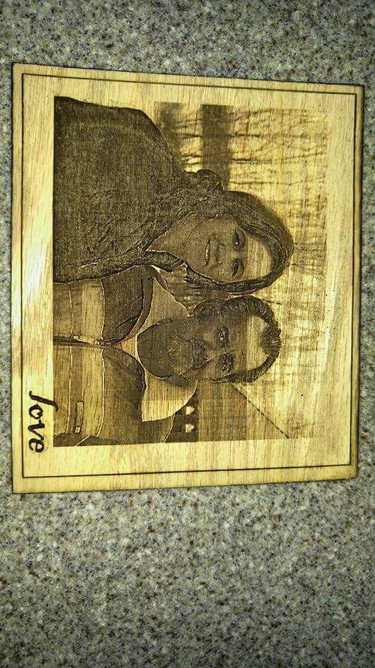

Trying my hand at engraving a photo.
what did you use for the software LaserDRW or CorelLaser?
@Michael_Otte what material did you use?
looks great
That came out pretty good.
I don’t get the grey scales though with either LaserDRW or Corel
@greg_greene I am using CorelLaser and used the instructions from this page http://support.epiloglaser.com/article/8205/50104/photo-laser-engraving-on-wood-with-CorelDRAW
My speed was 150 and 50% power on the stock K40 machine.
@Yuusuf_Sallahuddin_Y
Thank you…
@Alex_Krause
its just some thin board I bought from Home Depot, not sure what kind exactly.
@Michael_Otte is it solid or ply?
Very nice job with the photo engraving!
