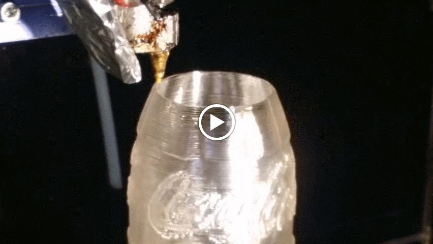

Trying PETG for the first time. Really good filament.
I liked the sample PETG enough to buy a spool, It’s pretty nice, though I’m still dialing temp’s in.
