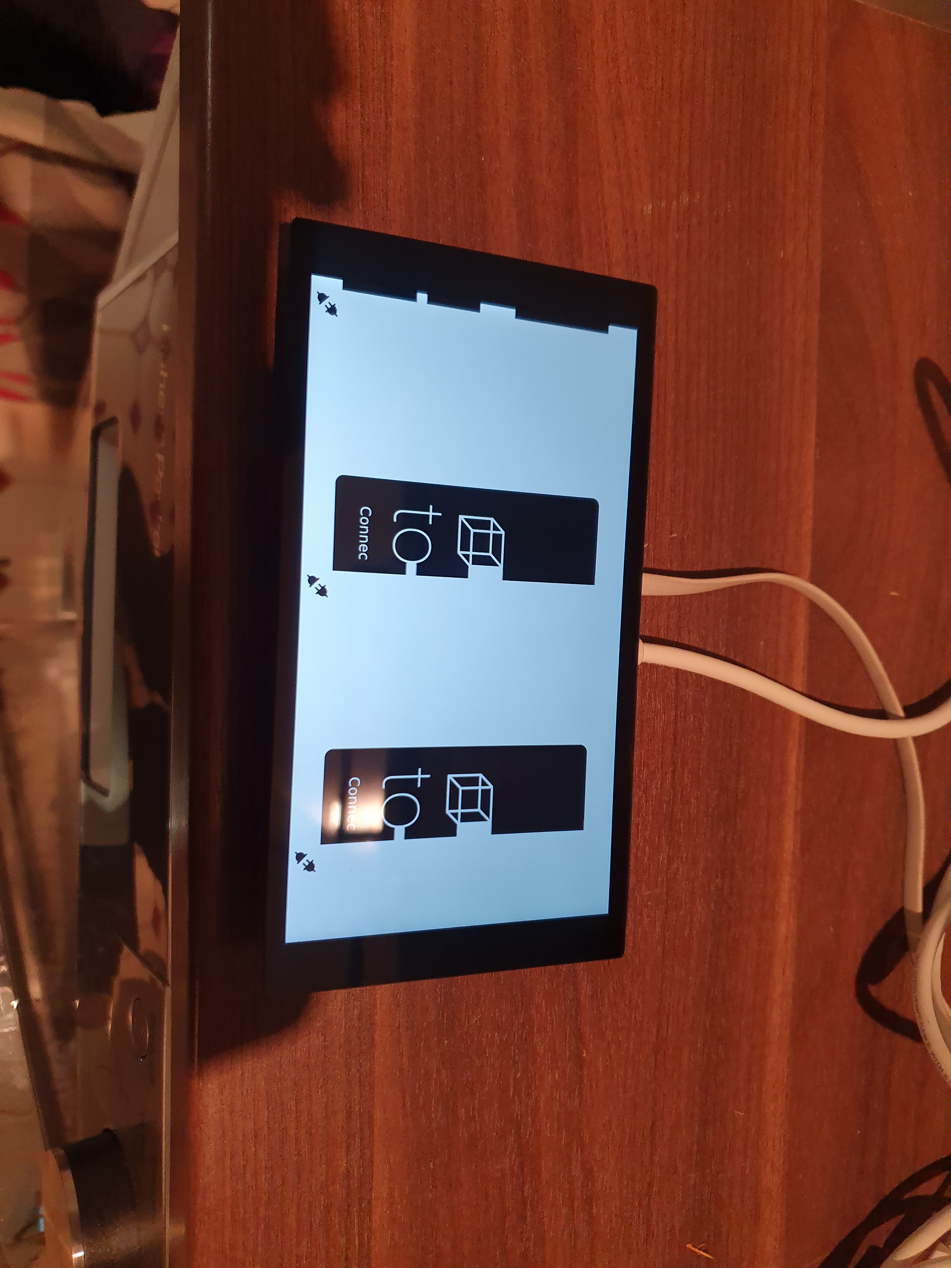

I’m having the same issue but the umikaze 2.2.1 rc3.
Even after adding this command to the uEnv.txt file cmdline
video=HDMI-A-1:1088x1980@60e
what are other people using to get the resolution to show up correctly?
if i plug the screen into my laptop it displays correctly and has the correct rotation automatically. so i assume the EDID is correct.

The rotation i’m happy with. but i’m getting 3 different displays across the screen. doesn’t seem to matter what resolution i try to force.
