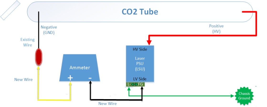

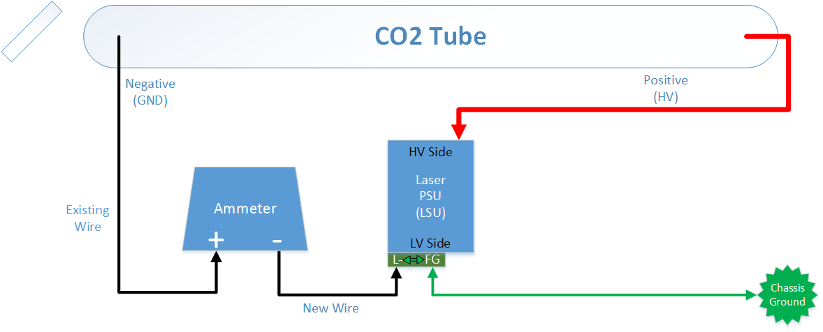

So I’ve got it figured out. I don’t know what that thing on the sidewall inside the laser is (looks like a coil). Anyways the cathode wire runs into one end of that and then out the otherside comes a yellow wire which attaches to the FG PSU input. I ran the mA meter between the yellow wire and the FG using the FG input in place of the L- input (as this was running to the chassis). My thought is if L- and FG are a chassis ground then the PSU input should also be common. I tested it and worked - although I dropped my meter and it remains at 10mA constantly (new one on order).
I’ll do up a fancy diagram like this one and post as well. I don’t proclaim to know what I am doing so I may have fluked out here so take my advice or don’t I can’t really tell you what to do, but heed all the warnings that everyone has expressed over fiddling around with the Power Supply.
