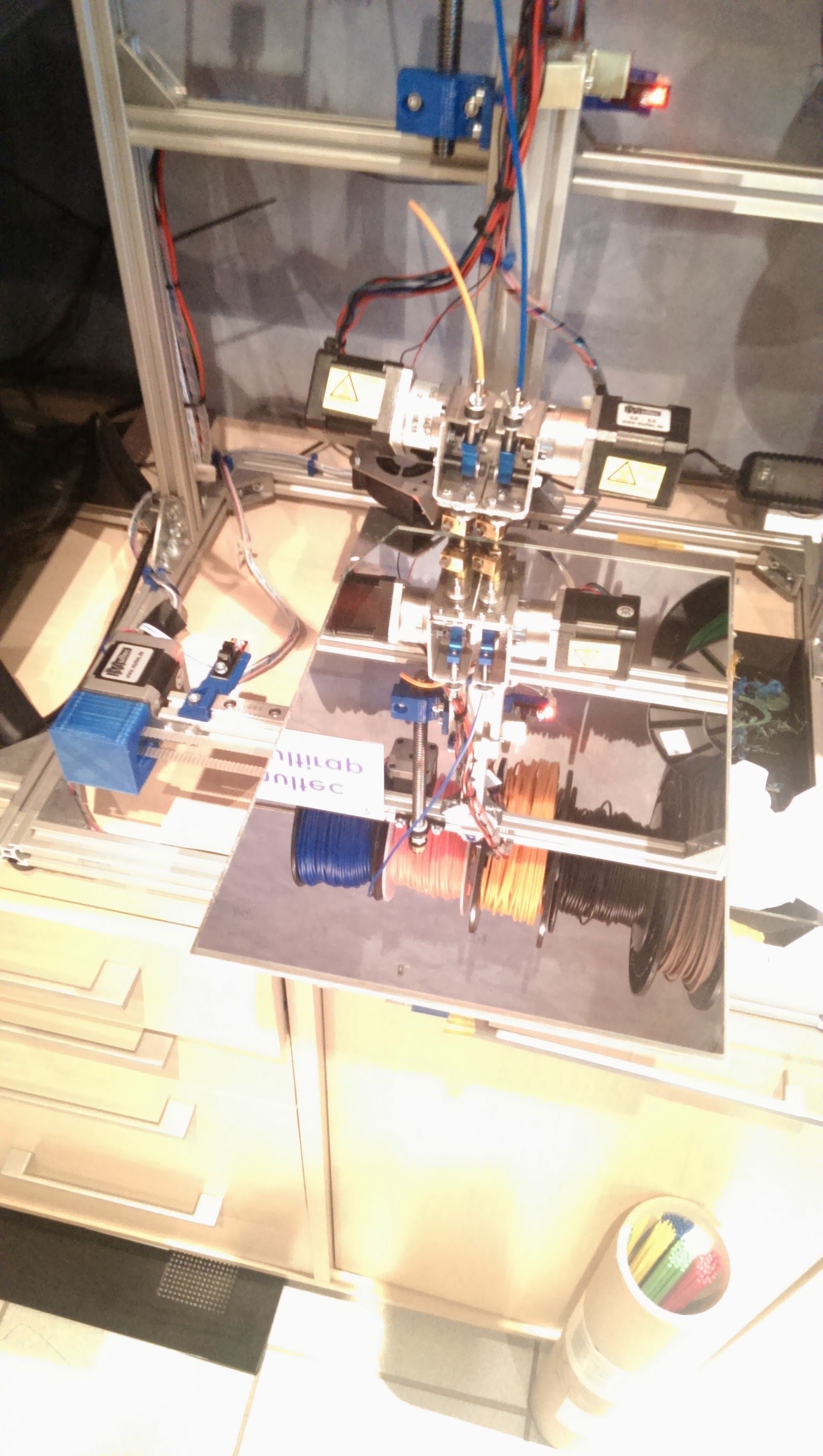

trying to print PLA on glass … just bought a 30x30 mirror and cutted it to the size of the print bed. It had some problems with adhesion with kapton tape and hope glass will work better.
