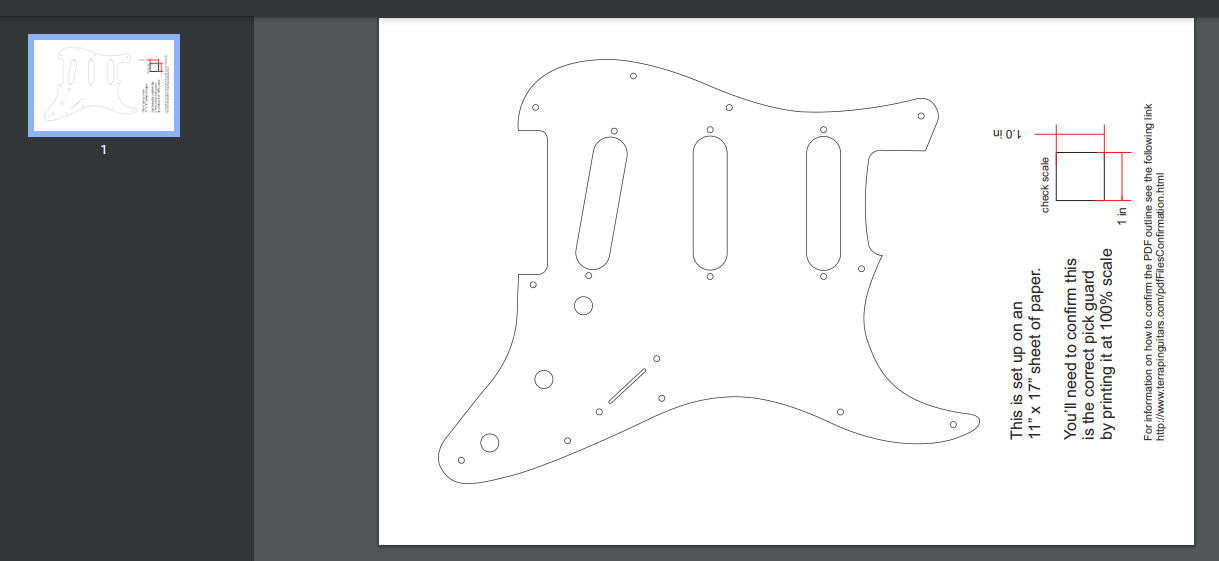

Trying to use a pdf but it get destroyed
hi all!, i have a problem, i have a pdf file that i need to use in lightburn, so i use inkscape to transfor the pdf into svg or dxf but everything that i do that strange things happent with the file
this is the pdf
and this is the dxf and svg
svg
after a full day trying to solve this i try to use one of this online web that make the conversion from pdf to dxf, is work good, but the problem is that when i do that i make a double lines that the original pdf don’t have, and i think is impossible to deleted that double lines
example
thanks !!
In LightBurn select everything and then use the ungroup command. When you do you should be able to delete the lines that you do not want.
