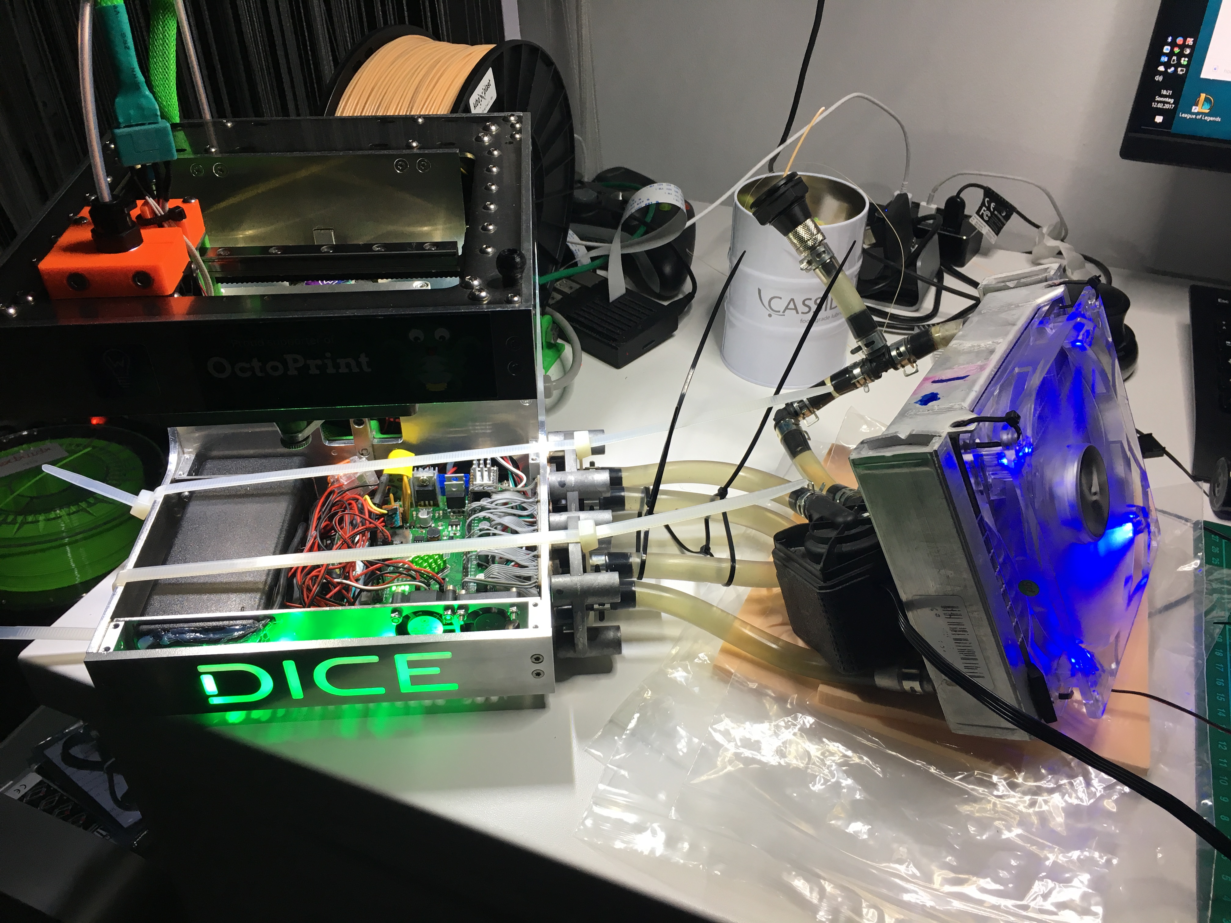

Re-using an water-cooling-setup from my old G5-Mac. Total overkill for cooling those drivers

I thought the drivers were supposed to dissipate heat into the Al frame quite well?
It turned out that I still need a small 5V fan to get at least the tinyiest amount of airflow. Totally passive this way is working only for shorter prints. 5+ hours and there are lost steps… And it is depending heavily on environmental temperature. If I could, I would redo the printhead with its partcooling. But there is no other way with the space given.
Fair enough. What about a heatsink with vertical fins on the back - you’d get some natural convection?
One needs the cooling right where the drivers are located…
…flatten a piece of copper pipe to run the liquid through right where the drivers are at!
Space needed for that! There is no space in the DICE left for playing around
There is no space on the DICE, period. I’m pretty sure the print goes above the lid
Well I guess I’m about to find out. Is the 3510 part cooling fan not powerful enough? I have experience with the slim 3507 and I needed two of them and need to be directly pointing to the tip of the nozzle. They are not really that powerful compare to the regular blower fan.

I don’t understand how the water cooling rig is helping cool the drivers.

@Jeff_DeMaagd the drivers are attached to the frame, and the cooling head is attached to the opposite side of the frame

Oh I see what’s going on. If water cooling is going to be the solution, further changes can probably use unmodified drivers and run a custom long heat sink.
Yeah, these trinamics run hot! Although I’m doing fine with an 80mm fan and some heatsinks. Rene does like his overkill though…
And I meant a custom long water block at that. I’ve water cooled my hot end upper block but didn’t consider the motor drivers.
Jeff I was saying that I can cool these drivers sufficiently with an 80mm fan blowing on some GDT-X9 heatsinks. I understood you were referring to a water cooling block. There’s no space on dice for an 80mm fan!
