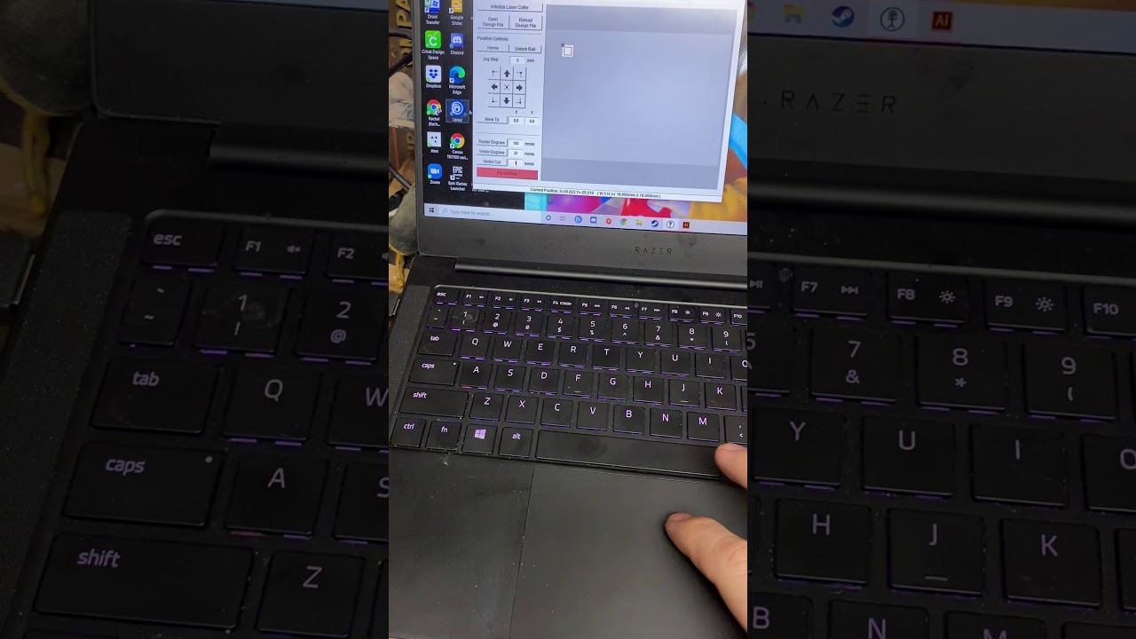

Here is a video link,
I noticed that the laser will fire if I press the “test laser” button. Could I maybe chock this up to a program error?
:0 I just noticed that my file outline in the video is in black and not red for vector cutting… I am going to assume that this is User error…

Im going to assume so. I pulled the xy axis yesterday afternoon as the existing bed is interfering with space in line with my focal length, and have yet to put it back in the chassis. I noticed my color coordination is wrong in the video as I was uploading it. It’s going back together after work, and I will post update as it comes. Ty! I filmed the scene when it happened, and I didn’t watch it until you asked about pictures, and I uploaded it.
