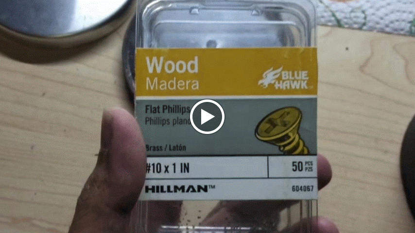

Tumbling process with copperFill parts with brass screws. Couple things to notice.
Tumbling process with copperFill parts with brass screws. Couple things to notice. Over 6 hours of tumbling blend the layers but some of the artifacts still remain. Noticeable ‘byte’ marks on the surface. There’s a lot of metal flakes/particles left over from the tumbling process. After a quick clean up the parts still remain golden/copper like.
Are the flakes from the print, or the screws? They look big enough to clog a nozzle.
The flakes are most likely from the screws. Near the edges and bottom of the barrel had tiny bits of materials. I’m guessing those are from the print.
