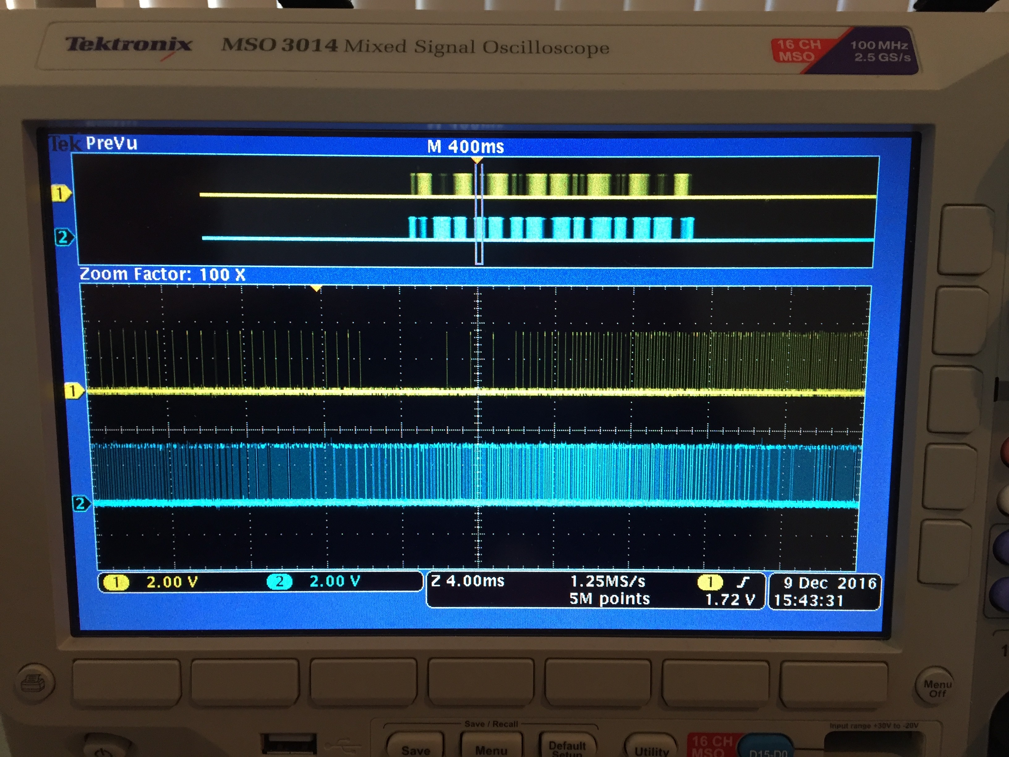

Tuning LW4 CAM to produce gcode which doesn’t starve Smoothie’s planner over USB. The two traces are X step and Y step.

How are you testing this?

This is for the path cam only; the raster cam will use a different code path (@Sebastien_Mischler 's). I capture the waveforms from a run and look for spots where both axis go quiet.
