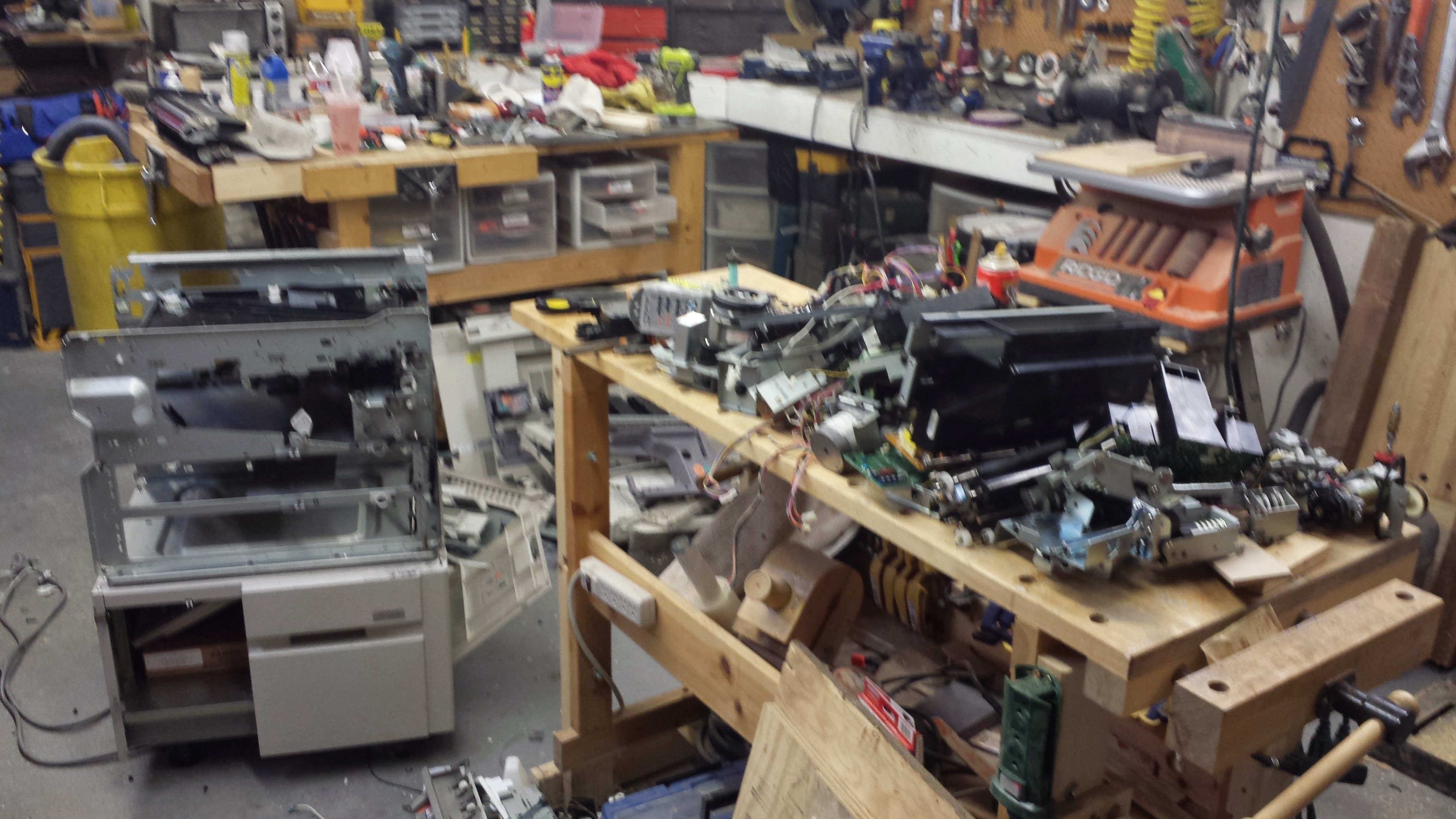

It is made from an old copy machine motor and cog belt and gears that I have been keeping (20yrs) for a rainy day.
There is lots of good stuff in a copy machine!
