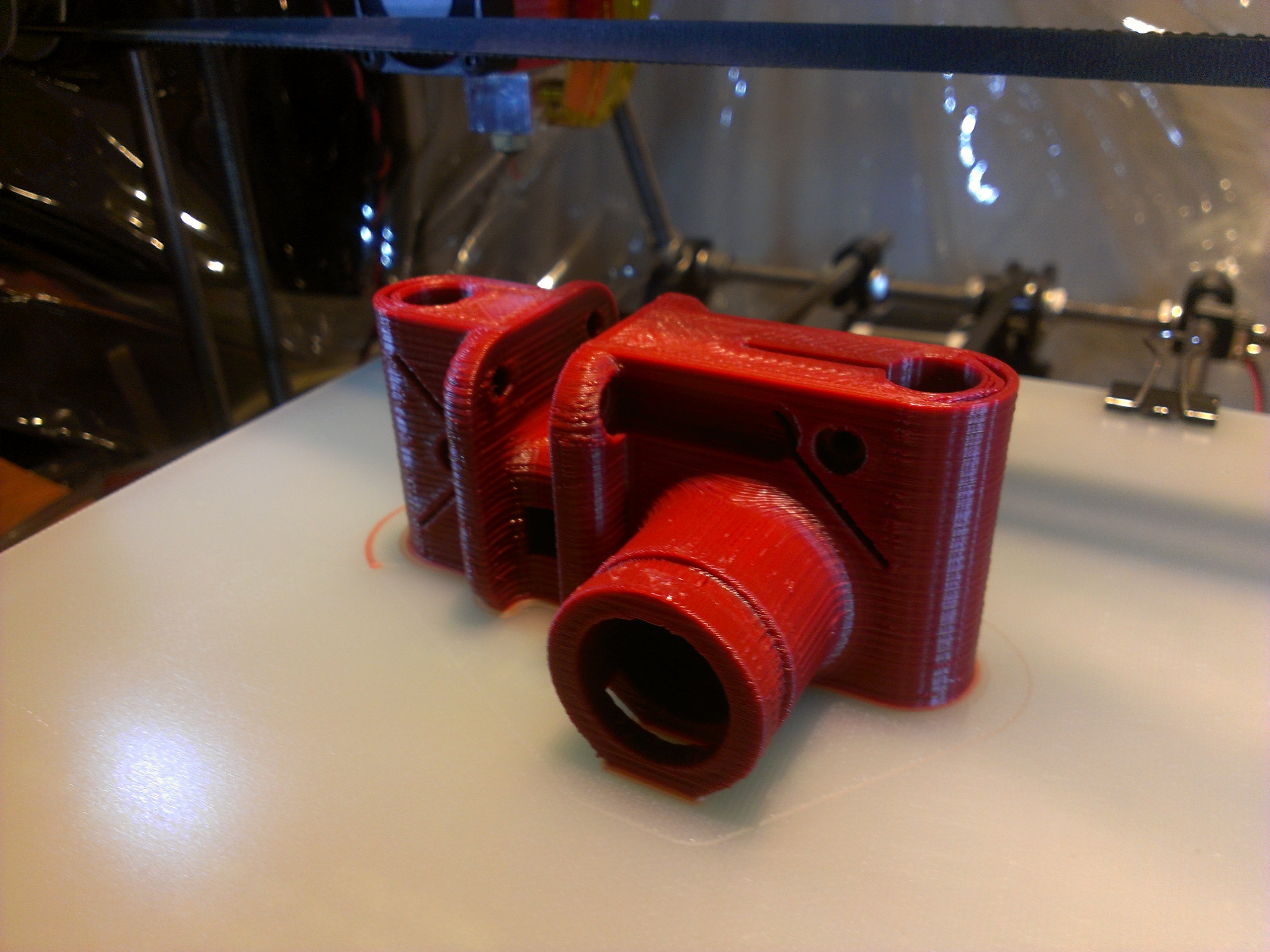

Turns out garolite is a great surface for ABS as well. I’m not going to miss taping bed plates. I did a really nice job only once, and promptly tore my nozzle through it.

Bed was heated to ~110C, seemed to stick very well and zero warping. Unheated might be ok for smaller prints, but the heated bed also keeps the ambient temp up, and I’ve found that helps get nice lamination between layers.

@Stephen_Baird Tried with no bed heat. Does NOT work. Not even worth a pic.
