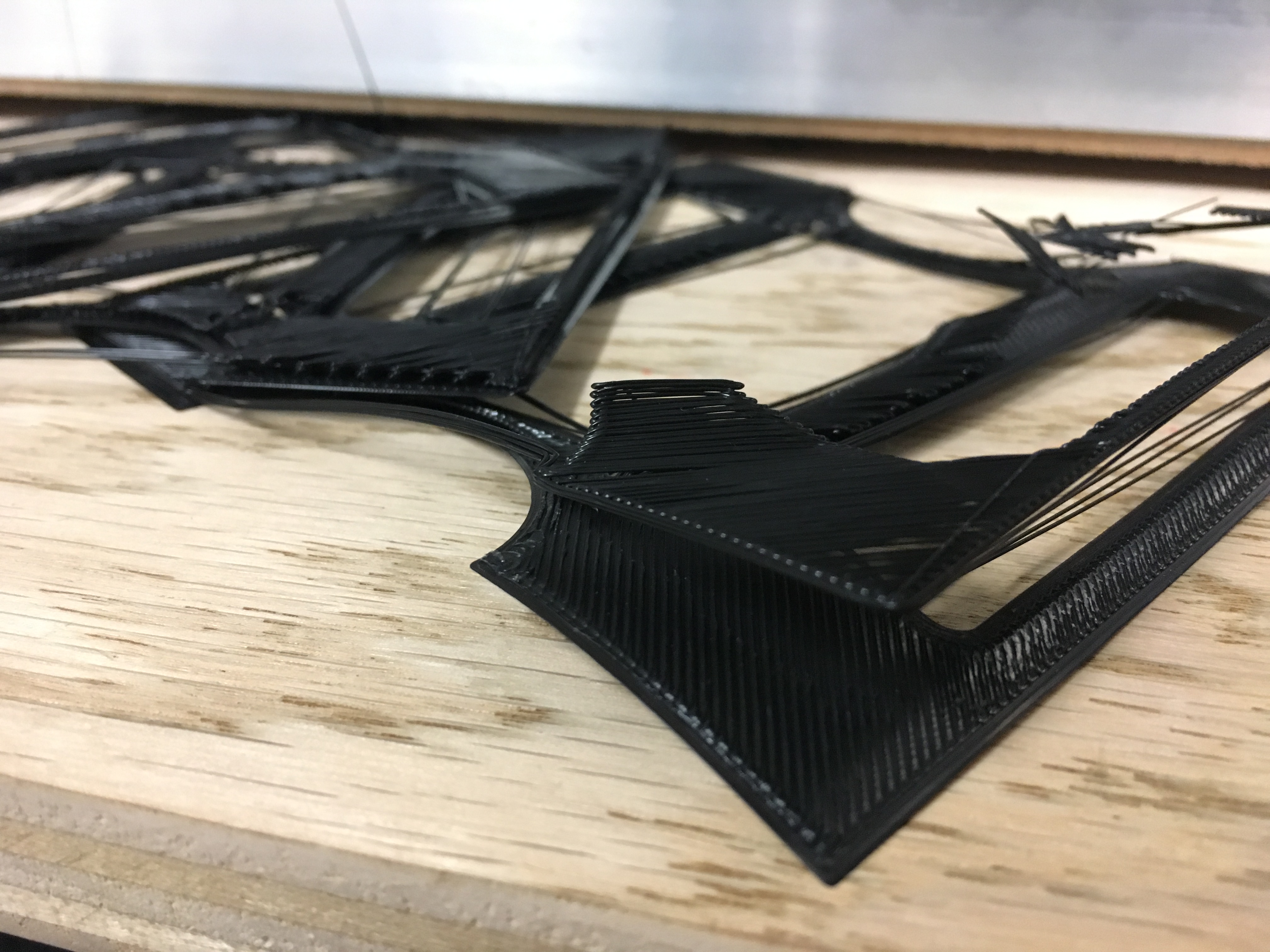

Turns out it was the drivers overheating.
So it’s doing small prints perfectly but the second layer is waaaaay to high up on larger ones…
Using an X5 GT SD2224 drivers.
My steps per mm are correct.
Need to resolve tonight, any feedback is helpful, thanks!
Any chance your z is drifting down? Am I correct that the first layer is perfect… But on the second layer it is too far from the first layer?
@Eclsnowman Yes you are, the same part works just fine when only printing one of them, but when I put 4 it fails. Maybe something with s3d?

@Dennis_P Preview is fine, have not tried another slicer as I don’t have time to reconfigure right now. Its weird because it only happens on large prints.
It actually happened on the first layer this time, but on one of the 4 parts. (not bed leveling issue)

I think it’s the drivers overheating and lowering the v ref. I don’t have a fan on em
Because it did it on the first layer on one when I printed it right after the other one. I think it’s slipping during z hop.
