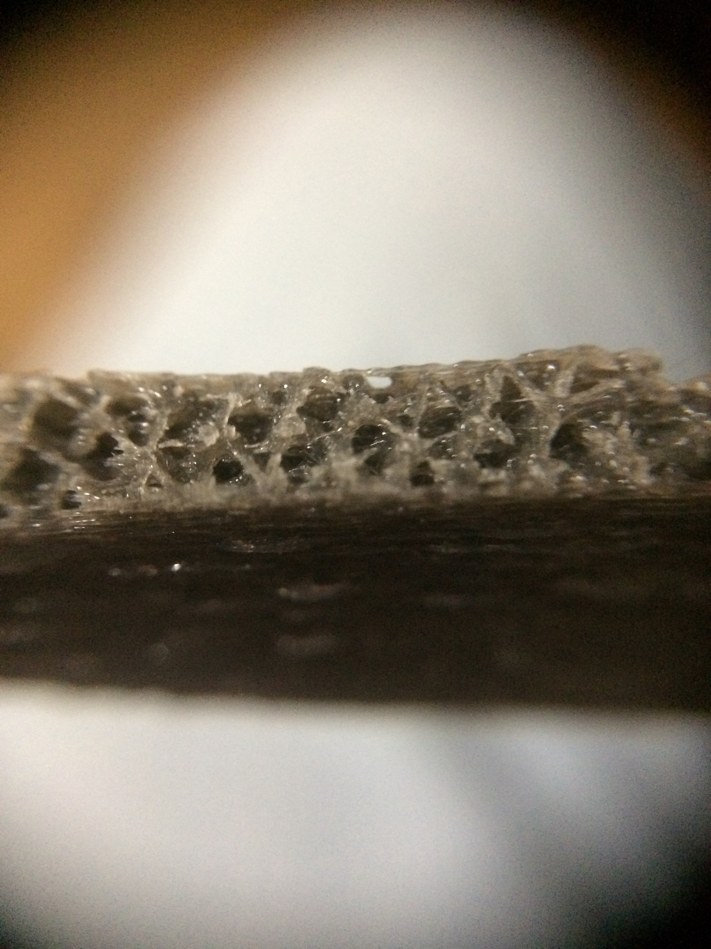

Two macro lens views of a failed print.
Black PLA, printed at 195C, fully water saturated.
Delaminates with very little force - also notice the “styrofoam” texture of the extruded plastic from the steam bubbles.
I wonder if “wet” PLA could be used as a support material for dry PLA…
If so, it would make wet PLA useful!
I had very similar outcome with PETG extremly under extruded.
