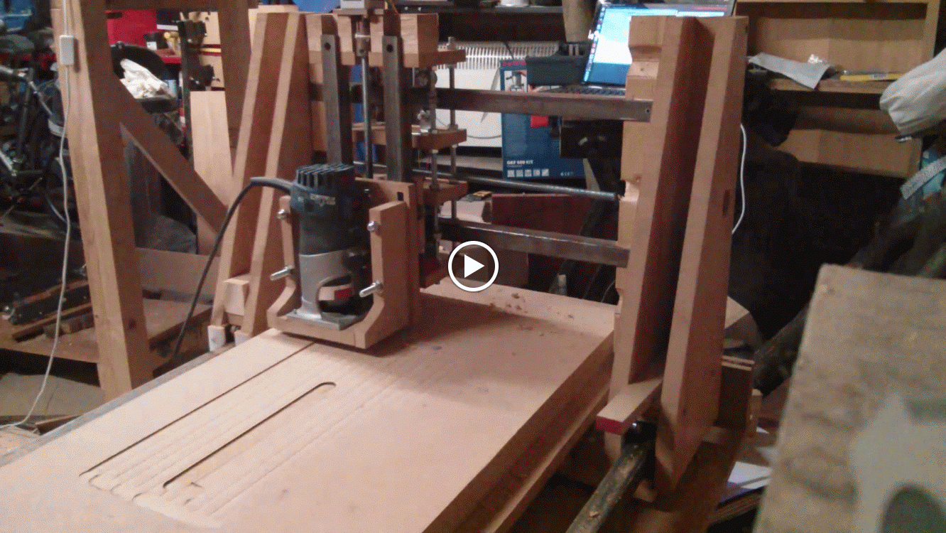

Two more time lapses of work to level the bed of my CNC and
Two more time lapses of work to level the bed of my CNC and beginning of some work to cut slots to allow me to bolt/clamp pieces to it.
Fairly boring videos, I’m just happy that it ran smoothly, nothing went wrong. Nice consistent movement.
The bed required a little hand sanding since the 25mm wide bit I was using was obviously not totally level to the plane of movement. It left very slight ridges between passes.
Sadly it does look like the z axis coupler has now broken. Finally admitted defeat and ordered a set of 3 proper metal couplers. Hopefully they won’t take too long to arrive.
