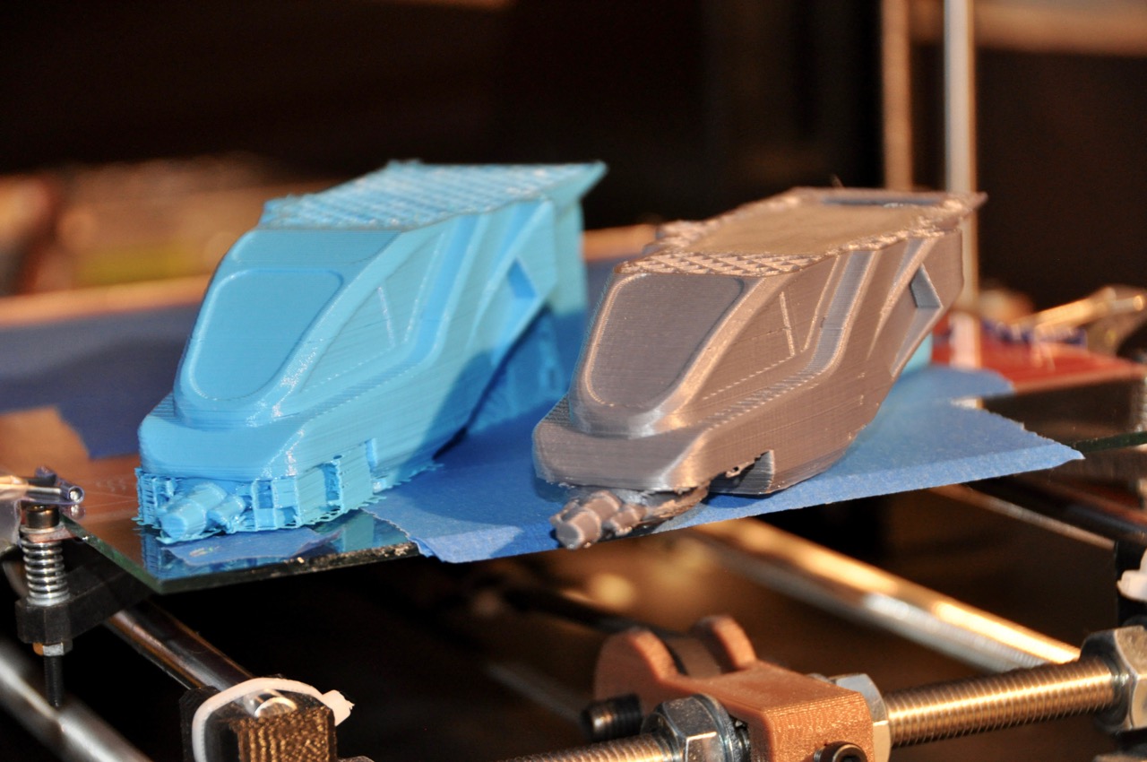

Ugh, now I’ve had it with my extruder. It’s burnt me twice now with slight deformation that’s lead to a wasted print (working on Halo drone). I have a direct drive that’s worked great for several months, but now it seems to be acting up.
Changed filament to see if it would follow it, but still had an issue. Yet, it printed all day yesterday another part with different PLA and didn’t act up… it’s so inconsistent.
I don’t have a lot of tension on it, and in the past when I’ve messed around with the springs it seemed like it’d be more likely to just gnaw at the filament and strip it. Printing PLA @ 205 @ 40mm/s. So it’s not like I’m winding it up, but it just seems to be erratic.
