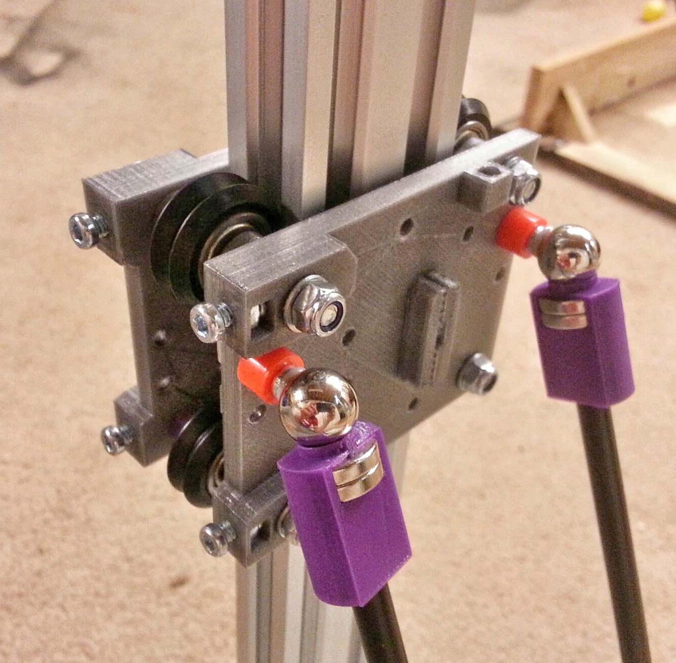

Uglybot carriage. V-slot wheels , double sided plate with wheel tensioners,
Uglybot carriage. V-slot wheels , double sided plate with wheel tensioners, magnetic rods on glued balls. It’s all coming together nicely.
Why don’t you use magnetic balls instead?
Magnetic balls that size are hard to find. Both the balls and magnets in UglyBot are from dollar store toys.
Interesting… what is the advantage of having two plates either side? as opposed to one thicker plate on one side like I have on the wolfstock?

@Wolfmanjm I found it more structurally solid this way. I tried single plate and it would flex a bit even though it had 50% infill. With this approach the plates can be thin and light.
